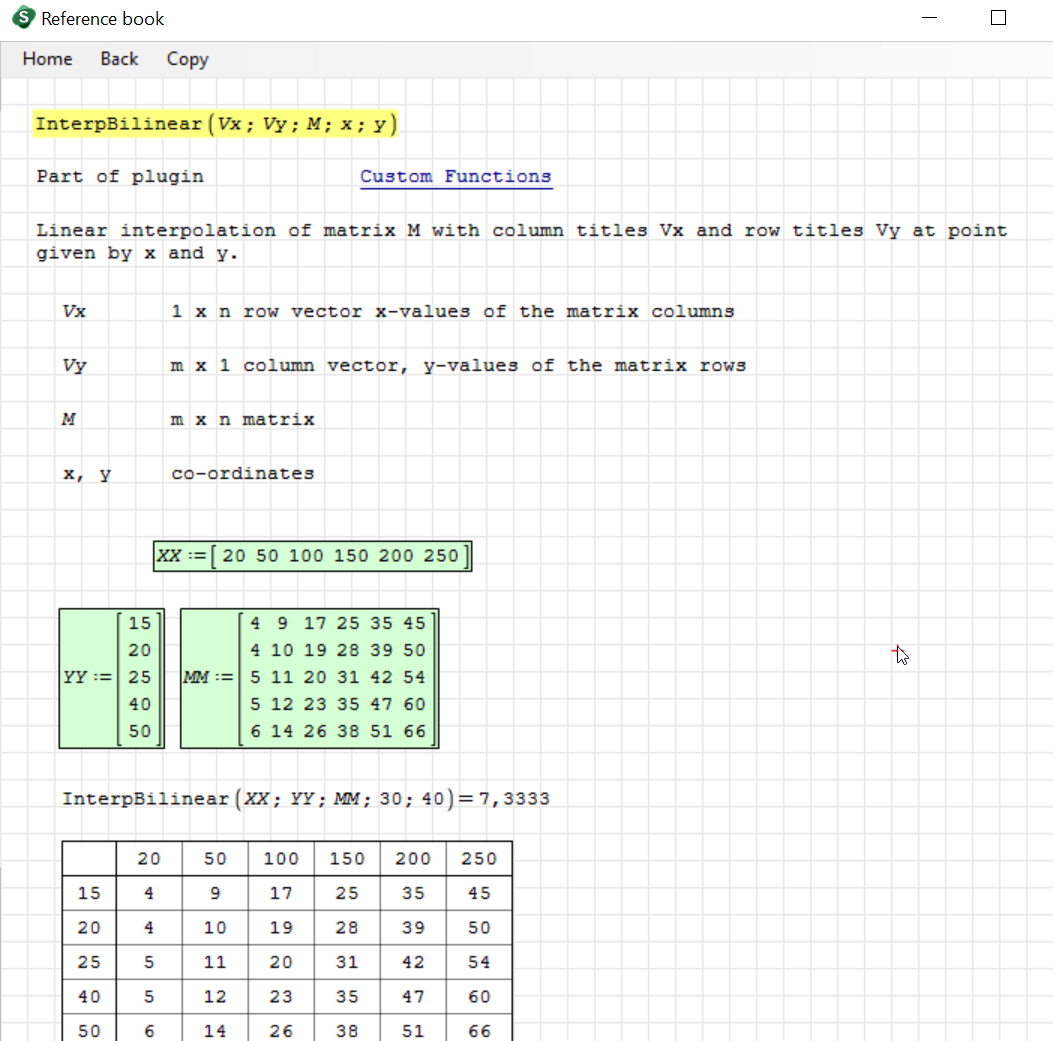

Look for InterpBilinear() function.
You can find more info in Reference Book.

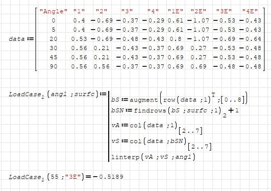

Using linterp() with a function is another way.
Function selects column according to input.
linterp_select.sm (8.1 KiB) downloaded 1471 time(s).

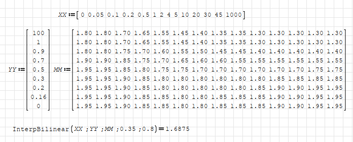

I'm quite satisfied with the InterpBilinear function. I'm exploring Jean's and overlord's additional suggestion but still it was already solved for me. Another question is that would that still work if I had to do interpolation in both the column values and row values such as in case below.
From what I understand, InterBilinear() seems incapable of doing what I aim to do. Do you have any suggestions?
#7 Posted: 1/18/2024 6:37:38 PM

From what I understand, InterBilinear() seems incapable of doing what I aim to do. Do you have any suggestions ?
If, I understand your request,
ForLoop algo style will do ... last example page 10.
Interpolate [Linterp, Spline2D].sm (212.07 KiB) downloaded 1369 time(s).

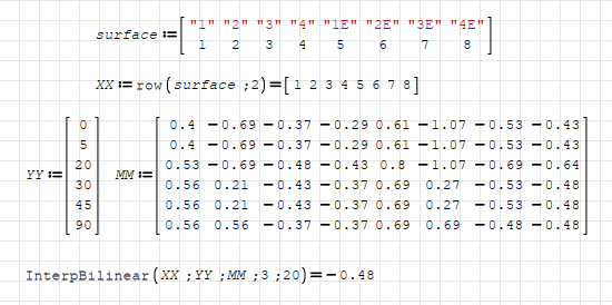

On the contrary, InterpBilinear() does exactly what you seek.
It interpolates both row and column values.
PS: I added extra values to accommodate ≤ and ≥ boundaries.
