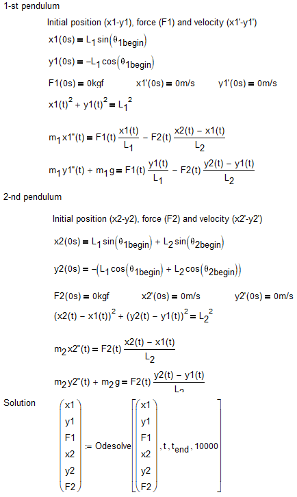

#1 Posted: 9/20/2026 10:08:09 AM
I feel the model is not correct - help please!
Pendulum-2-animation.sm (22.59 KiB) downloaded 162 time(s).
Edited 9/20/2026 10:09:28 AM

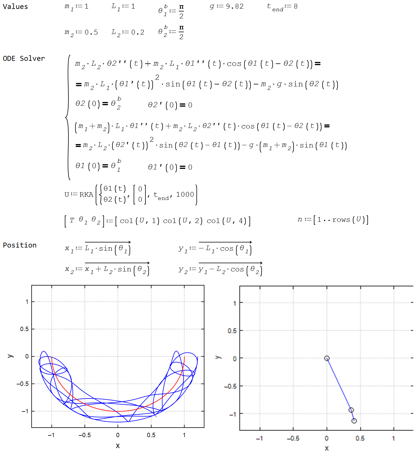

#2 Posted: 9/21/2026 11:02:24 AM
Hi Valery. The system is coupled. This is a way to solve it.
double_pendulum_lagrangian.sm (122.44 KiB) downloaded 159 time(s).
double_pendulum_lagrangian.pdf (637.78 KiB) downloaded 113 time(s).

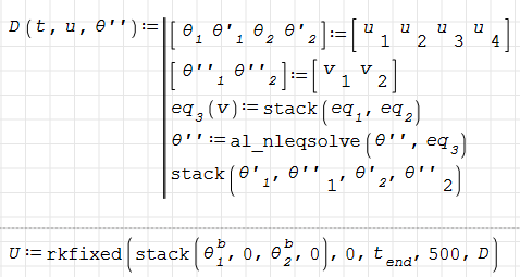

#4 Posted: 9/21/2026 4:47:18 PM

The RKA function includes the necessary procedures to solve hard coupled systems.
double_pendulum_RKA.pdf (483.53 KiB) downloaded 103 time(s).
double_pendulum_RKA.sm (43.57 KiB) downloaded 152 time(s).
