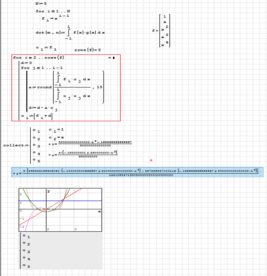

#1 Posted: 6/22/2016 1:32:27 AM
Not as clean as Mathcad, but can be done terms by terms.
Smath 5346 does not recognise the dot product integration.
I might have missed some coding for solving algo style.
Symbolic Gram-Schmidt.sm (109.26 KiB) downloaded 1473 time(s).

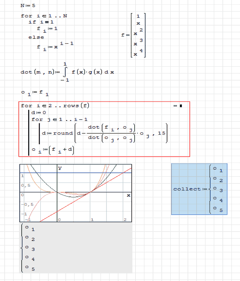

#3 Posted: 6/23/2016 1:24:27 AM
#4 Posted: 6/23/2016 11:48:33 AM
A small improvement.
I correct , because the " dot " function does not work correctly
Carlos.
ortogonal_Jean_CBG_R2.sm (13.77 KiB) downloaded 1456 time(s).
Carlos.
#5 Posted: 6/23/2016 2:04:40 PM
Thanks, Carlos: Your 2nd version is OK.
Still, can't export the reduced components in visible form.
Will work again tonight.
Cheers, Jean
Cheers, Jean
