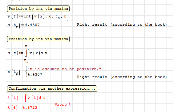

I've been trying some silly problems in dynamics in Smath.
Came across an integration expression and tried to do it numerically.
Then, I tried with another "int" function and came out different results.
My questions is: should we always take on Maxima plugin's expression?

There were mistakes in your file. You should pay attention to definite and indefinite integrals and the function arguments when using definite integrals. See the picture with corrections and hover the expressions in the file to see the difference.

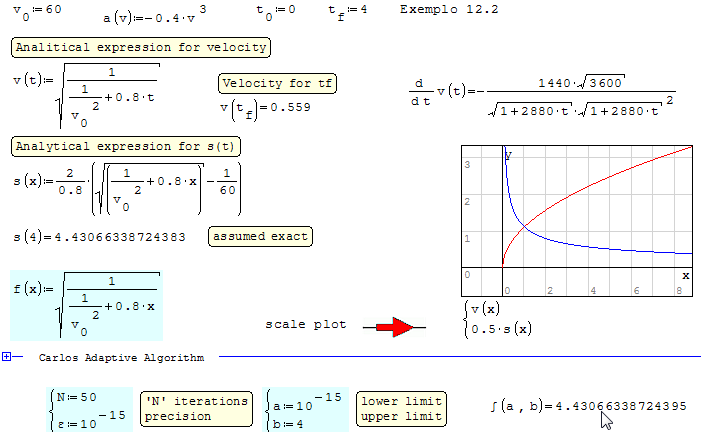

Good idea to save Carlos adaptive integration.
Exceptional numerical integrator that meets Mathcad/Mathsoft Adaptive.
I have exhausted this integrator, it ranges from exact2atleast 6/8 decimals.
Hope it clarifies your questions ... Jean
exm_12_2_din Sanity.sm (28.48 KiB) downloaded 1116 time(s).

I see what you did but with respect to "t" and "x". Just to be clear, the definite integral k(t) goes diffent because of the Constant? The constant C=0 and the expression is evaluated for t=4? I think I get it now.
Thanks, Rodovan.
Sure it does.
I'll test this code.
Thanks, Jean.
