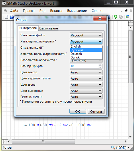

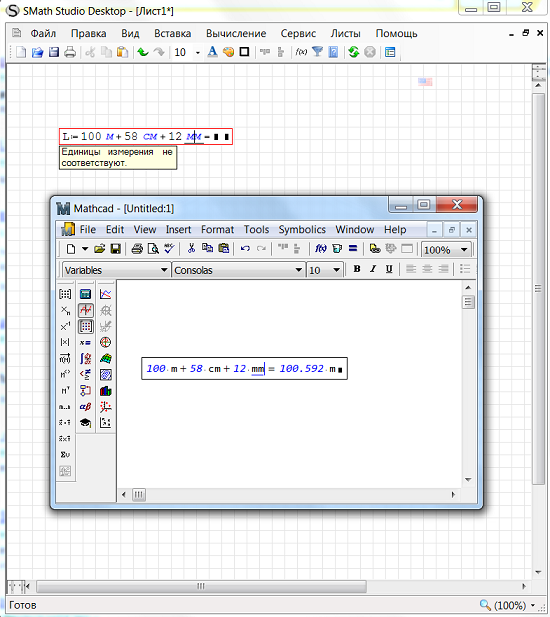

Why this not working?

#3 Posted: 7/11/2014 3:42:26 AM
1403 likes in 1708 posts.
I use russian units. They do not work. I don't know is this a bug or not. English units are working fine.

#5 Posted: 7/11/2014 4:40:15 AM
Thank you Radovan, now it works fine (default was English.).
