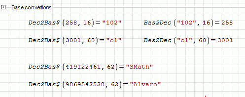

Hi. I use this.
numbase.sm (12.8 KiB) downloaded 1869 time(s).

You need to define the complement value. Windows calc use 2^64, but SMath only can use 2^32. Check the attached.
BTW, I see a lot squares in (I know not all ASCII code can be displayed) definition of N$256, It seems N$256 is not needed?
Anyway, thanks!
I use N$256 sometimes for convert full ASCII text to a decimal number. For example, the string "SMath" in base 256, using N$256 is 353468707687 in base 10.
numbase.pdf (507.83 KiB) downloaded 1085 time(s).
numbase.sm (209.55 KiB) downloaded 1770 time(s).

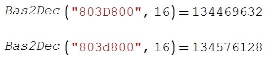

This is cool, but Bas2Dec("803d800",16)=134576128 - is no true. True resulit is 134469632. Help me pleas.
