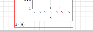

#1 Posted: 10/3/2018 8:46:22 PM
Basile
Basile
8 likes in 172 posts.
When I try to type i(t) I get i*(t), automaticaly. Why?
Thank you,
Basile

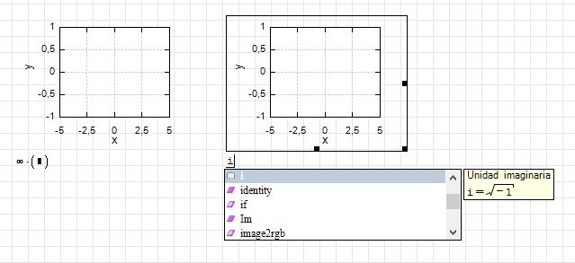

#3 Posted: 10/4/2018 1:07:27 AM
Alvaro Diaz Falconi
Alvaro Diaz Falconi
992 likes in 1675 posts.
Basile
Hi Basile. Remember that i isn't unfortunately like other variables, and it is reserved for the imaginary unit (In mathcad it is 1i or 1j, much better than the SMath convention). Probably the problem is related with this, because you can see the same behavior with the infinity symbol (Ctrl-z).

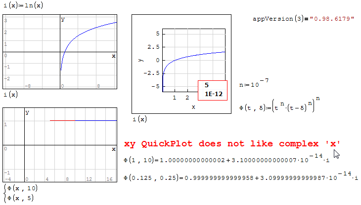

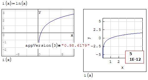

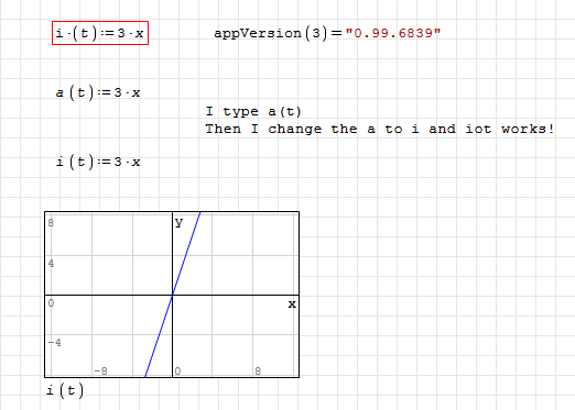

#7 Posted: 10/27/2018 10:48:14 PM
Basile
Basile
Hello to All,
This is my solution:
Basile
