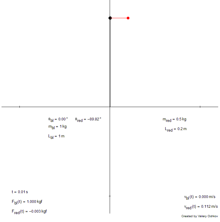

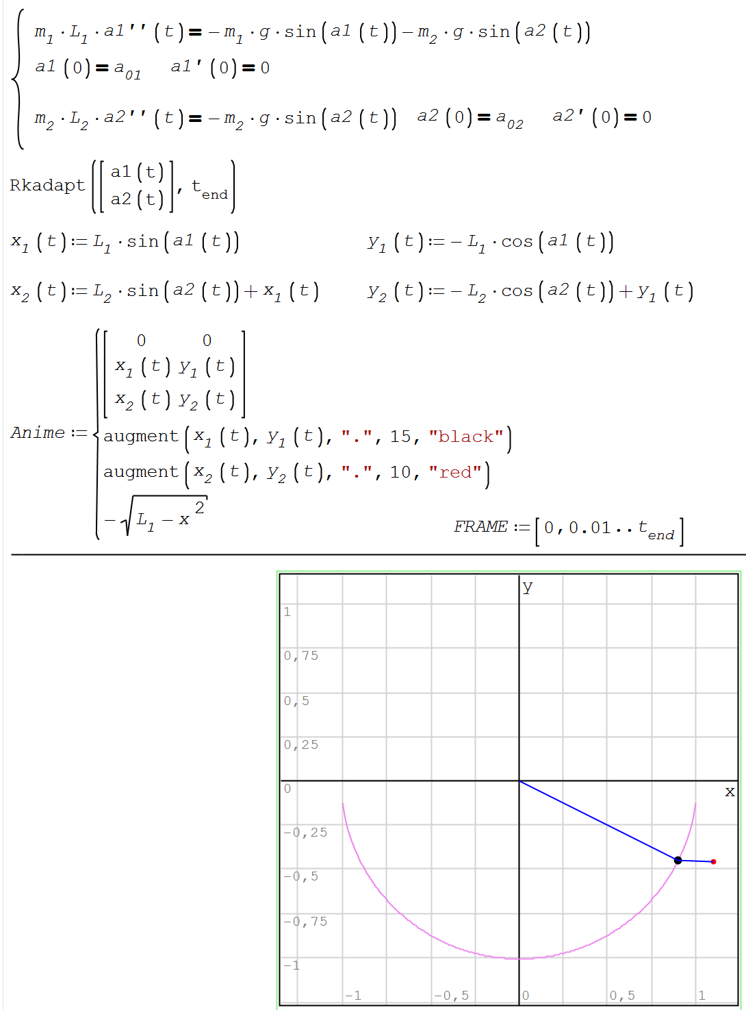

Hi friends!
Now I am on the forum again!
Anime2.sm (55.59 KiB) downloaded 935 time(s).
But the model is not correct. See please Alvaro model!
Edited 10/30/2025 7:22:14 PM

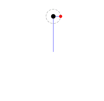

#2 Posted: 10/29/2025 10:45:45 AM
1,555 likes in 1,867 posts.
Using X-Y Plot
Anime2-xyplot.sm (57.84 KiB) downloaded 960 time(s).
sergio 10/29/2025 2:50:17 PM, Ricardo_Herrera 1/3/2026 2:15:17 PM

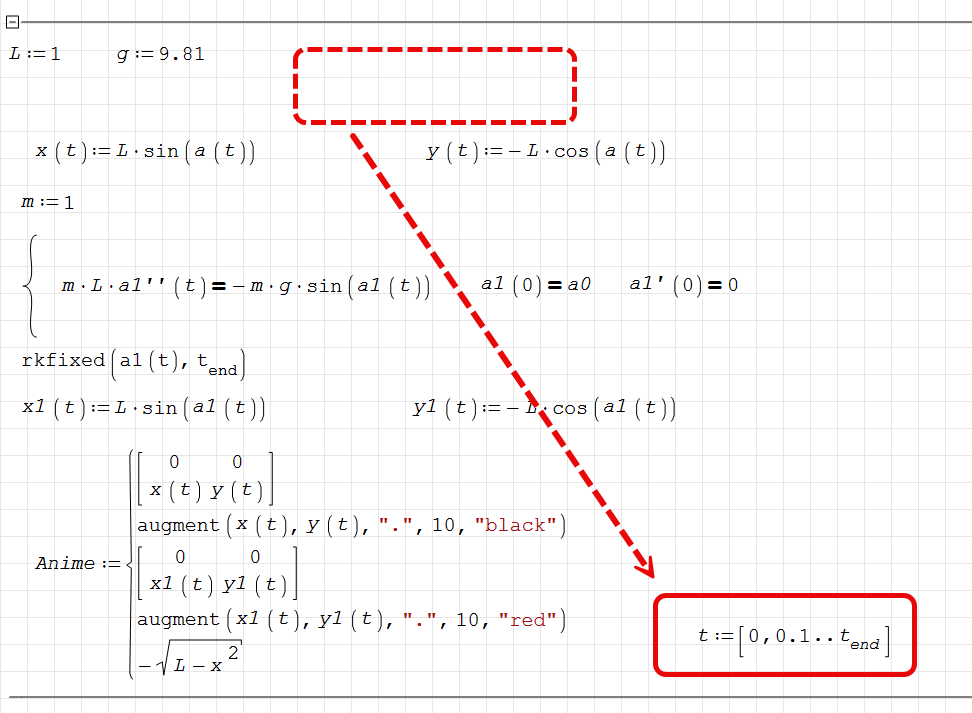

#4 Posted: 10/29/2025 1:56:31 PM
Valery Ochkov
Valery Ochkov
66 likes in 697 posts.
Anime-x-y-plot.sm (18.24 KiB) downloaded 911 time(s).
And where here is a bug?
#5 Posted: 10/29/2025 2:01:44 PM
Vector t must be defined below before the component.
The animation feature is still being developed when I have time for it.
Edited 10/29/2025 2:05:45 PM
Alvaro 10/30/2025 7:04:42 AM

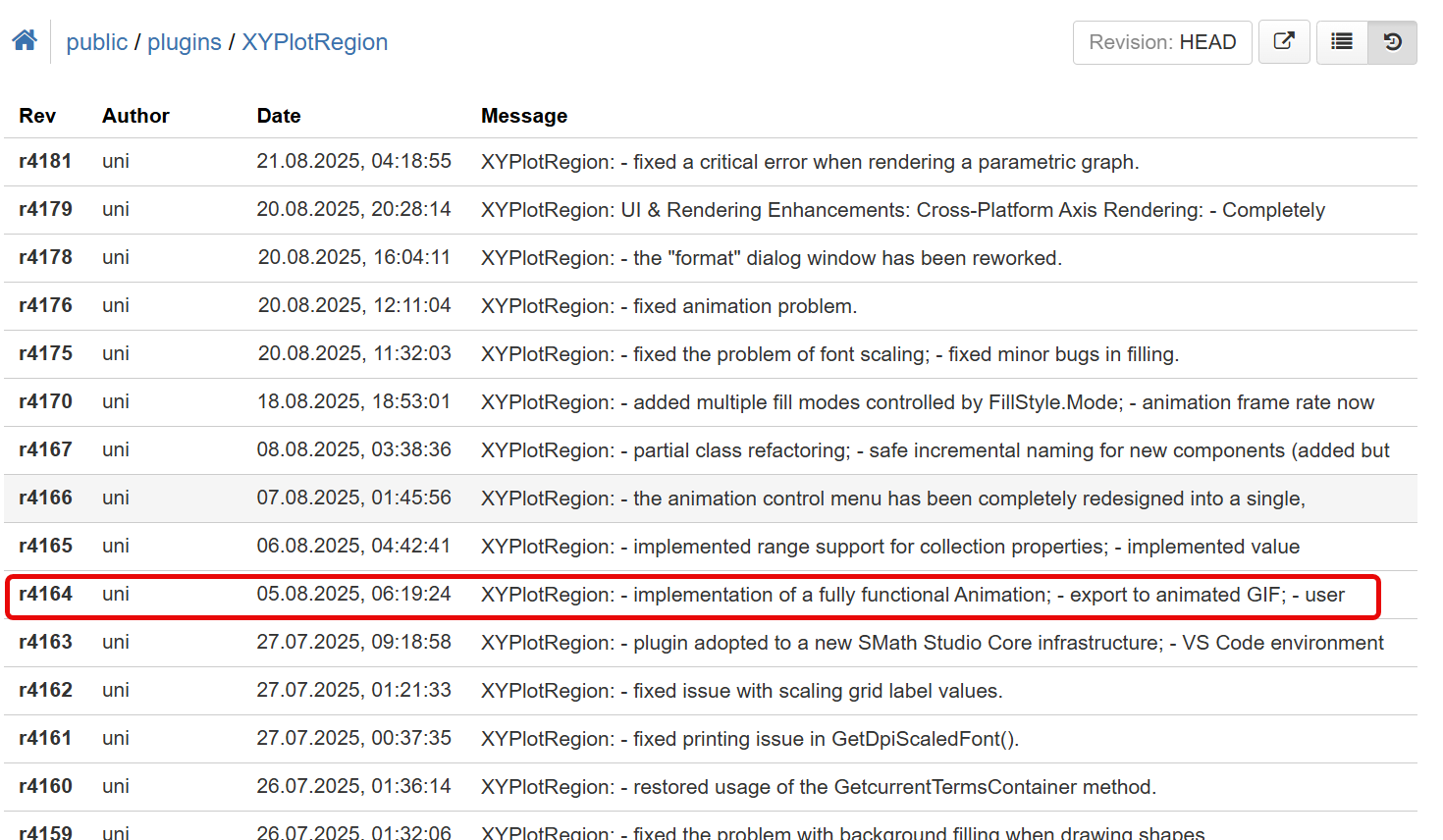

#7 Posted: 10/29/2025 6:19:29 PM
Quote
Слава, а когда этот новая версия плагина появилась?
В конце лета.

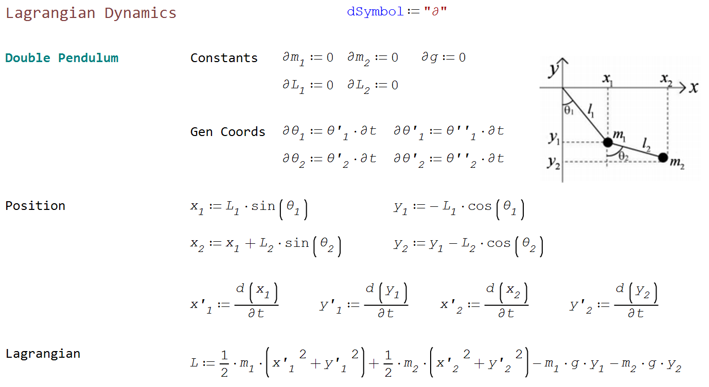

Hi. My approach to solving the double pendulum problem.
double_pendulum.sm (75.92 KiB) downloaded 970 time(s).

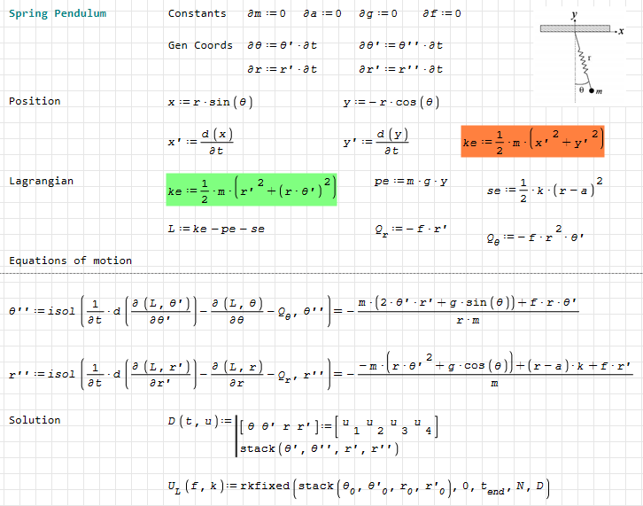

Hi. Using pure SMath code to deduce the equations of motion from the Lagrangian, with the functions in this post: https://smath.com/en-US/forum/topic/AeeMSM/Using-differentials.
double_pendulum_lagrangian.sm (174.64 KiB) downloaded 929 time(s).
double_pendulum_lagrangian.pdf (503.4 KiB) downloaded 701 time(s).
Valery Ochkov 10/31/2025 7:37:56 AM, sergio 10/31/2025 8:48:37 AM

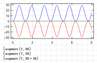

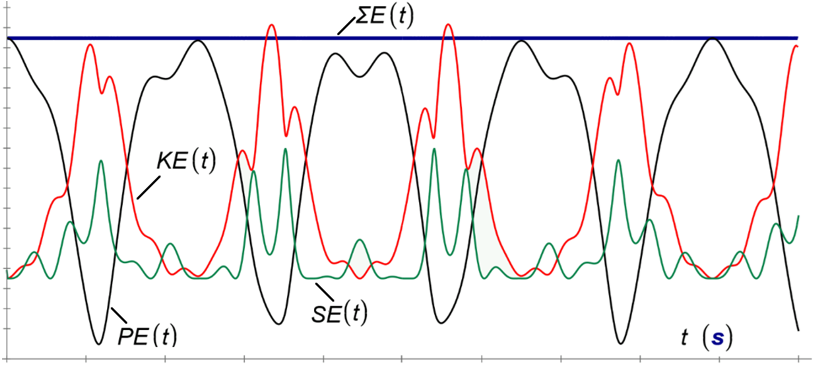

One my plot:
Change of three types of energy of a swinging pendulum on an elastic suspension - SE - the spring energy

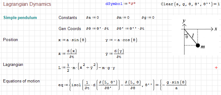

Alvaro, hi!
Is it posibble to solve the single pendulun problem with Lagrangian and rkfixed but without the al_nleqsolve function?
Edited 11/5/2025 8:29:15 AM
#19 Posted: 11/6/2025 4:03:01 AM
Hi Valery. For the single pendulum you can get the lagrangian from the olf post about differentials ( https://smath.com/en-US/forum/topic/AeeMSM/Using-differentials ) It's very simple and doesn't require much processing to use rkfixed.
For the double pendulum, you can use Newton-Raphson to solve the system within the function D. Here, a very simple version of the method is used.
double_pendulum_lagrangian-NR.sm (178.15 KiB) downloaded 909 time(s).
Something similar applies to the pendulum with a spring. Note that the Lagrange equations become somewhat complicated because I use the x,y coordinates to calculate the kinetic energy, and SMath cannot simplify trigonometric functions. However, if you use r, θ' (in green), the equations of motion are greatly simplified. But that breaks the principle that the program should do the calculations, not the user.
Hi Alvaro!
Can you create this simple sm-file with animation? Single pendulum!
Thanks!
