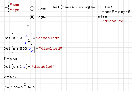

For the given problem a global switch would be handy, which could disable all assignments with the right hand side being numerically evaluable.
You can fake this behaviour by using a custom conditional definition statement. You also might need a modified display function, because for numeric results symbolic optimization just gives ugly formatting.
This is a step towards the right direction. Again, however :-)
  1. Your file does not work for me. If I choose sym, I get "a not defined" in the last line P:= I am using the portable version and everything seems to be up to date.
  2. The usage of a function drastically decreases the readibility of the sheet.
  3. It is not efficient. I have to put every variable definition in the ugly function just to display one line symbolically.
  4. You probably didn't mean g_e but g :d
