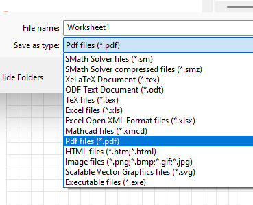

Save As
Select *.pdf

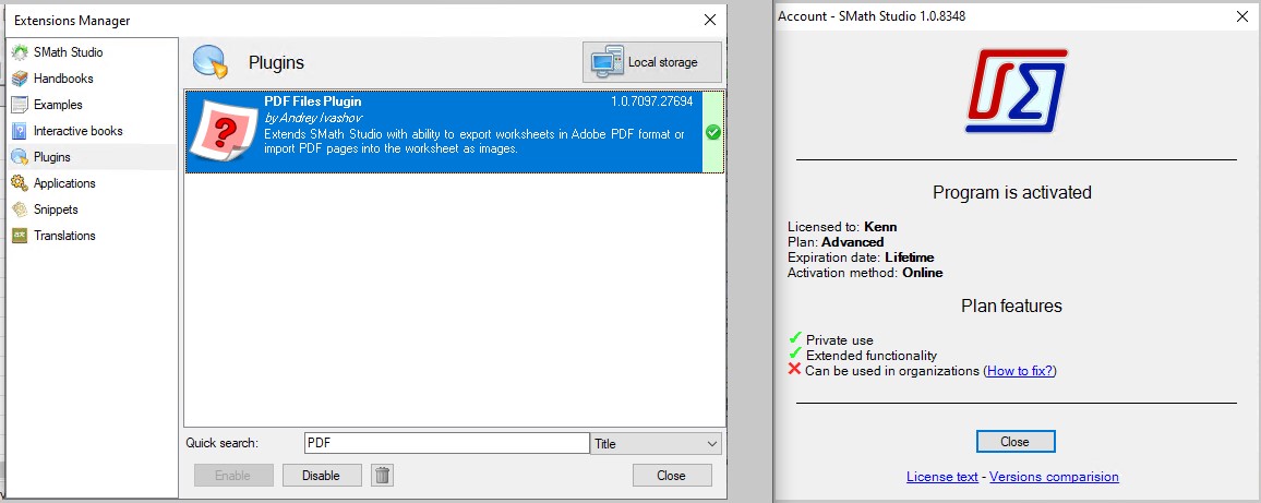

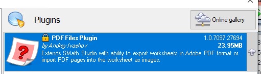

With the evolution of SMath's EULA, those supplementary plugins created by Andrey are no longer available to Basic accounts (Please take note of the "Locked" icon):
This plugin can still be used, but it is limited to user accounts with Extended Functionality:
It is possible in the last upgrade you made to the SMath Studio; you 'lost' the permissions to use the 「PDF Files Plugin」 if you don't have an activated account.
Solution:
- Upgrade/activate your Smath account to access this plugin.
- Use the "PRINT" command and select a PDF driver (which typically comes installed with your PDF application (e.g., Adobe, Nitro, Bluebeam, etc. )
