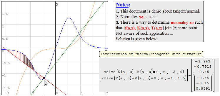

#1 Posted: 9/15/2017 10:17:00 AM
Maths Tangent.sm (24.15 KiB) downloaded 1250 time(s).

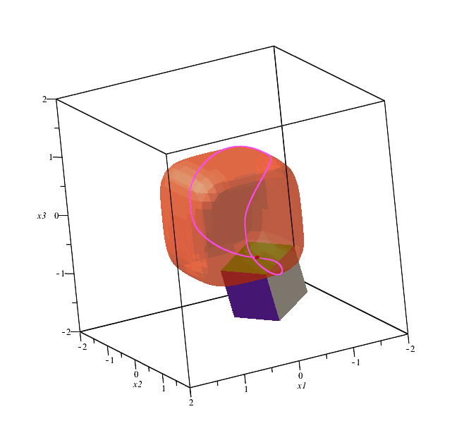

From Maple.
One face of the cube belongs to the tangent plane to the surface at each point of the curve.
http://www.mapleprimes.com/posts/208425-Tangent-Plane-As-The-Square-At-Any-Point-Of-A-Smooth-Surface-#comment202577
