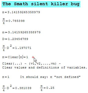

I have a good idea about this plugin, having programmed WaterSteam in Visual basic
years ago. The plugin may be OK by itself but it suffers from the Smath silent
killer bug. Naturally, getting some properties uses some of the related constants.
Then, getting next properties does not renew constants previously used, and you get
any zombie result. Nothing to do untill this bug is cleared. The "clear" function
works, does not work.

#4 Posted: 3/31/2016 10:22:27 PM
Please don't reply: do this, do that
Smath does NOT do first, I don't have to do what it should do.

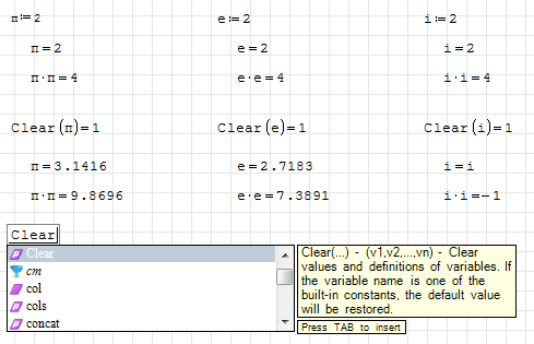

#6 Posted: 4/1/2016 6:56:42 PM
Jean, thank you for pointing out the different behavior of Clear about built-in constants. My fault, was in my knowledge and I've forget to document it.
I've updated the plugin (SS 0.97.5346 and later), now the description of Clear(...) reflects also this behavior.
