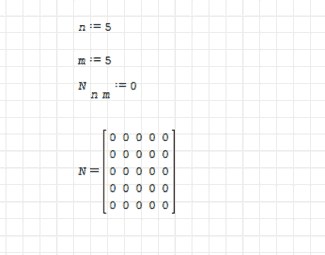

WroteWroteDoes anyone know if it is possible to define a variable which will determine the size of a matrix.
Both ways: empty and '0'
Thanks Jean Giraud,
Your solution suits the best for me, but I can not reproduce it. See below. What do I do wrong?
Beste regards,
Rens
Matrix.sm (31.46 KiB) downloaded 1257 time(s).

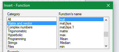

#6 Posted: 3/24/2018 7:13:25 AM
WroteI can not reproduce it
Do one of the following:
- press CTRL+M
- write mat(
- write mat and press the tabulation key
- on the right side of the windows, click on the first element of the Matrices toolbox
![2018-03-24 11_04_19-SMath Studio - [Page1_].png](/en-US/files/Download/gmTkdZ/2018-03-24-11_04_19-SMath-Studio---[Page1_].png)
- use the function dialog (press CTRL+E or choose the Insert > Function menu item or click on the fx symbol from the toolbar) choose the Matrix and vector group and search mat (click on whatever item and press m), then double click it or click on the insert button
File not found. File not found.![2018-03-24 11_13_08-SMath Studio - [Page1_].png](/en-US/files/Download/n3o6og/2018-03-24-11_13_08-SMath-Studio---[Page1_].png)
