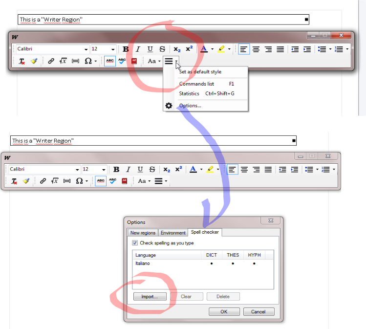

Thank you for the pointer it has started to help. However, I'm stuck once more. In you documentation page 4 you discuss Global options gained from the toolbar "More" ...
I'm probably being particularly thick today but I don't see a More item on SMath menu bar, or as an item on any menu, and the Writer Region Settings toolbar has no menu at all. Without access to the global options I am unable to import a spell checking file.

This could help you

Thank you so much!
