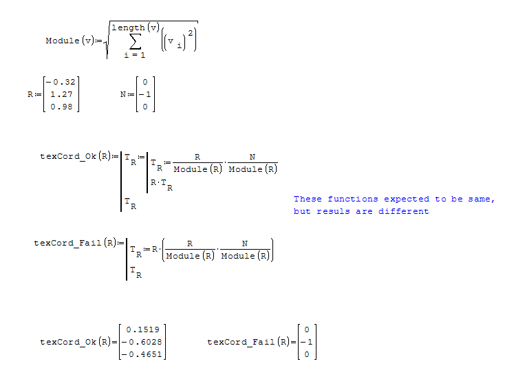

Here is in attachment files illustrating wrong computation of local variable.
Using version 0.98 (build: 5935)
bug.sm (7.04 KiB) downloaded 1270 time(s).
#2 Posted: 5/9/2016 11:12:24 AM
Mike Kaganski
Mike Kaganski
184 likes in 434 posts.

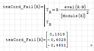

Seems that it incorrectly optimizes the order of evaluation (despite brackets explicitly set).
This looks like a bug.
Aside, please note that this may be simplified like at the top of the screenshot.
Submitted SS-2340
A workaround:
And BTW, you may rewrite your Module() like this:
because scalar multiplication of vectors is sum of products of their corresponding elements multiplied by cos of angle between them - and for identical vectors, cosine is 1.

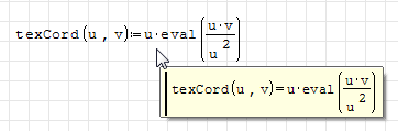

Define as function for greater functionality/elegance.

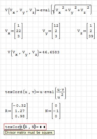

Are you using matrices curved lines?
I get squares.
Thanks,
Basile
#6 Posted: 5/11/2016 11:54:12 AM
Jean,
Are you using matrices curvedlines?
I get squares.
Basile,
I'm at Smath 5346. The matrix square bracket came recently
with some of the latest nightly build. Smath 5346 does not
have the matrix square bracket, which I love very much.
The 2nd level bracket in formula is still missing [I think ?].
Cheers, Jean

Jean,
Any idea why does not evaluate but gives error message?
Basile
#8 Posted: 5/12/2016 12:08:22 AM
Jean,
Basile
...as it looks there is a pair of missing brackets in eval(,)
