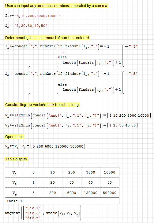

#3 Posted: 3/5/2021 3:01:06 PM
This seems to work for worksheet (.sm) form, but no luck with "SMath Viewer".
It basically builds a multi-element vector from a single string entry.
It works in the viewer, but you can't change the input string in any way.
Maybe the str2num is not supported by the Viewer?
Variable Vector Length Data Input.sm (13 KiB) downloaded 95 time(s).

So after doing some digging on the forum I have found that in older versions (97.5737) the modification of text strings was fully functional. For some reason it was disabled, I really can't see why this was done as it solves the major issue of standalone data entry that Smath Viewer has.
Related Topic
Some feedback form the SMath Gods would be nice...
I made an exe that does the same as my previous post, and it works as I intended, not all the same features are available in 97.5737, but as a proof of concept it worked. I was able to enter data into one input box a string with comma separators and then use that data in operations within the exe. I was then able to change the data by editing the input into the input box.
Variable Vector Input Test (97.5737).exe.zip (378 KiB) downloaded 80 time(s).
You can enter two vectors containing equal number of elements, change the length, numbers, and if works just fine!
No table region in 97.5737, so just deal with the string output, but you get the point.
Why can't we do this with the latest version?
Related Topic
