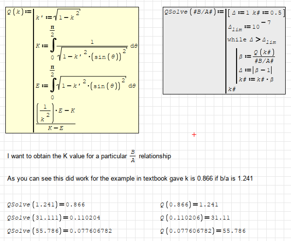

Good day everyone,
I am building a Hertzian stress calculator and got stuck at the step where I calculate the k value for a particular B/A reationship.
Any help will be appriciated
contact stress calc.sm (22.69 KiB) downloaded 1213 time(s).
#2 Posted: 10/20/2022 11:48:46 AM
ryno
ryno
0 likes in 2 posts.
We also know than K will always be in the range (0,1)
The equations presented above is obtained from the book Advanced Mechanics of Materials by Boresi Et al

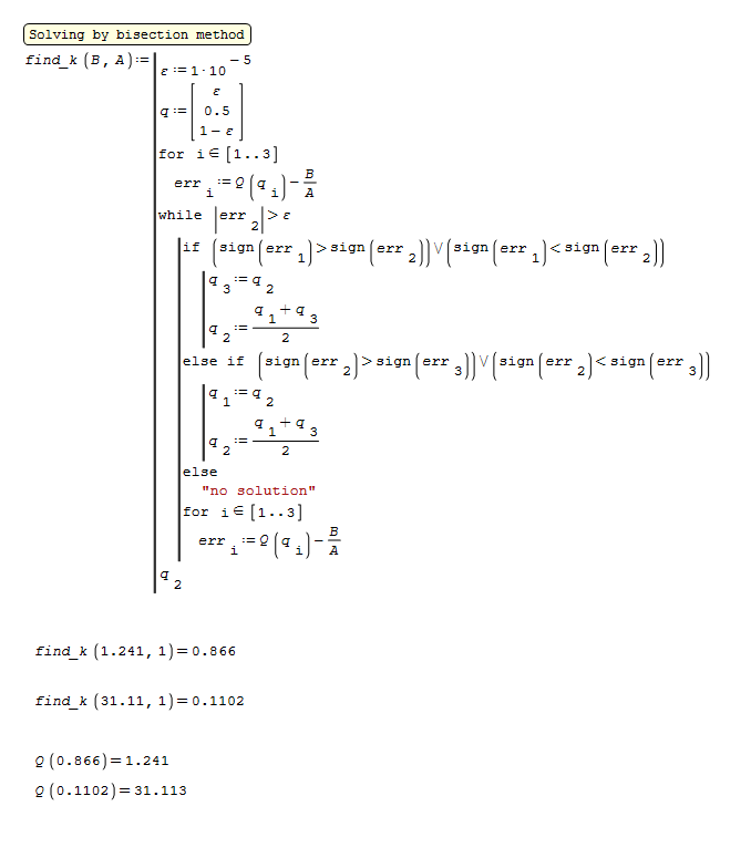

#7 Posted: 10/24/2022 8:29:42 PM
Oscar Campo
Oscar Campo
135 likes in 309 posts.
Good day everyone,
Solving by the old bisection method:
contact stress calc_by_bisection.sm (26.36 KiB) downloaded 1220 time(s).
sergio 10/25/2022 2:02:00 PM, Alvaro 10/26/2022 2:25:00 PM
#8 Posted: 10/25/2022 12:01:21 PM
598 likes in 1,380 posts.
Solving with a custom algorithm.
contact stress calc_2.sm (21.66 KiB) downloaded 1243 time(s).
3 users liked this post
Oscar Campo 10/25/2022 12:07:00 PM, sergio 10/25/2022 2:02:00 PM, Вячеслав Мезенцев 10/25/2022 12:43:00 PM
#9 Posted: 10/25/2022 12:08:25 PM
Oscar Campo
Oscar Campo
Very elegant!
