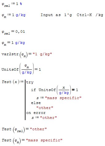

#3 Posted: 4/3/2018 11:38:47 AM
You might use an undefined custom unit 'g/kg for mass specific humidity. This gets carried on because SMath has no idea what to do with it.
unittest.sm (5.92 KiB) downloaded 1155 time(s).

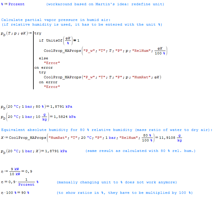

Thank you for the information and thanks for the workaround idea, Martin.
I decided to redefine the percent unit so that I can easier enter the g/kg ratio. The disavantages are that I have to use the unit % for relative humidity and that I cannot convert other ratios or efficiencies directly into percentages, but have to do it manually by multiplying it with 100 % (which is okay for me):

I would be very cautious with re-definition of built-in units. This increases the chance for your document to be misunderstood (including by yourself).
What was the disadvantage of defining a custom unit "g/kg"?
Cross check your calculations
