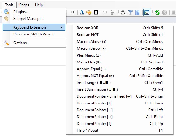

#5 Posted: 12/15/2022 4:56:54 PM
Salutations!
If you are used to Mathcad 15.0, you will have difficulty Creating/Navigating a worksheet because SMath has limited support when it comes to hotkeys/keyboard operations. SMath requires a fair amount of operations to be achieved via the mouse [🖰], which can be annoying (and time consuming) if you wish to type a lot of math/text quickly.
Whereas I did identify some remedies/workarounds (i.e., insert ▮⊕▮ (xor Operator) via HEX code 00A4 [Currency sign symbol: ¤]), this remains a work-around and does not actually address the issue. Therefore, I developed the following code:
'VB.net - Framework 2.0; Windows 10 Pro x64; SMath 0.99.7822.147 [English, USA]
keybinding_with_IPluginMenuExtender.vb.txt (37.17 KiB) downloaded 1434 time(s).
Preview:
Q: ) Will you be deploying this as a SMath Extension?
A: ) No, I do not plan to. As to why, the reason is simple: I do not know how this plugin will behave across different languages/keyboard configurations/operating systems. Before I could release a plugin I am proud of, I would need to address the implications that will result from these different configurations. In addition, such a plugin would beg the developer to permit users to customize key bindings to any given action; I do not have the time to develop such a great utility. Finally: such a plugin has the dangers of being greedy; I would not be able to guarantee such a plugin to respect (either by yielding or overtaking) keystrokes reserved by any given plugin.
Q: ) Why is this code written in Visual Basic and not C++
A: ) VB.net is not the better language, but rather I cannot ignore the benefits of VB within my profession. It is easy to read, less prone to make syntax errors, has a large range of implementations from VBScript in Mathcad, to VBA in MSOffice, from VB6 to VB.net in VSTO/Desktop applications. With that being said, I will not be posting the C++ equivalent as I am not proficient in doing so; I apologize for the inconvenience.
With that being said, here are some of my 'lessons learned' during my research:
May this be of Good Help, Merry Christmas;
- Kenny Lemens, P.E. ᵂᴵ

Imports SMath.Manager
Imports SMath.Controls
Public Class FormControl_4a_Implementer : Implements IPluginMenuExtender
Private disposedValue As Boolean 'Generated by Default
Public Sub Initialize() Implements IPlugin.Initialize
'Throw New NotImplementedException() 'Generated by Default; Comment out/delete for plugin to execute
End Sub
Public Const CURSOR_STEP As Integer = 10 'Number of pixels to move cursor; referenced by: (btnKeyPress11 .. btnKeyPress15)
''' <name>GetMenuItem</name>
''' <author>Kenneth M. Lemens (username: lemensk)</author>
''' <date>2022-12-15</date>
''' <type>IPluginMenuExtender</type>
''' <summary>Adds MenuButtons to the Menu Bar
''' MenuButtons are assigned Shortcut keys, to be used within a document (regions need not be selected)
''' Shortcut keys to Mimic some Mathcad 15.0 Keypresses, enhances ability to insert operators within SMath
''' MENU BAR BUTTON LAYOUT:
''' [Tools]
''' [Keyboard Extension]
''' - 「Ctrl」+「%」 :: Boolean XOR (Exclusive or)
''' - 「Ctrl」+「!」 :: Boolean NOT
''' - 「Ctrl」+「-」 :: Insert a Macron (bar) Above the Previous Character
''' - 「Ctrl」+「_」 :: Insert a Macron Below (undlerline) Above Previous Character
''' - 「Ctrl」+「+」numpad :: Plus Minus Sign (Returns a set of 2: the sum And difference)
''' - 「Ctrl」+「-」numpad :: Minus Plus Sign (Returns a set of 2: the difference And sum)
''' - 「Ctrl」+「~」 :: Approximately Equal to (「Ctrl」+「Alt」+「=」)
''' - 「Ctrl」+「Shift」+「~」 :: Approximately NOT Equal to
''' - 「Ctrl」+「;」 :: Range variable [a .. b] (step = 1)
''' - 「Ctrl」+「4」 :: Vector sum
''' - 「Ctrl」+「Shift」+「Enter」 :: Move ✛ to Start of Next Line (Line Feed & Carriage Return Only) "Ignore Region Interaction" Mode --- DocumentPointer - Line Feed [↩]
''' - 「Ctrl」+[↓] :: Enter "Ignore Region Interaction" Mode --- DocumentPointer [↓]
''' - 「Ctrl」+[←] :: Enter "Ignore Region Interaction" Mode --- DocumentPointer [←]
''' - 「Ctrl」+[→] :: Enter "Ignore Region Interaction" Mode --- DocumentPointer [→]
''' - 「Ctrl」+[↑] :: Enter "Ignore Region Interaction" Mode --- DocumentPointer [↑]
''' </summary>

Preview:
[Tools]→[Keyboard Extension] (by lemensk)
author: Kenneth M. Lemens (username: lemensk)
date: 2022-12-15
type: IPluginMenuExtender
summary:Adds MenuButtons to the Menu Bar (w/ hotkeys):
Hotkeys work within region, or creates a new region
https://en.smath.com/forum/Default.aspx?g=posts&t=23271
|| MENU BAR BUTTON LAYOUT ||
[Tools]
- 「Ctrl」+「%」 - ▮⊕▮ Boolean XOR (Exclusive or)
- 「Ctrl」+「!」 - ¬▮ Boolean NOT
- 「Ctrl」+「-」 - x̅ Insert a Macron Above
- 「Ctrl」+「_」 - x̲ Insert a Macron Below
- 「Ctrl」+「+」numpad - ±▮; ▮±▮ Plus Minus Sign
- 「Ctrl」+「-」numpad - ∓▮; ▮∓▮ Minus Plus Sign
- 「Ctrl」+「~」 - ▮≈▮ Approx. Equal to (「Ctrl」+「Alt」+「=」)
- 「Ctrl」+「Shift」+「~」 - ▮≉▮ Approx. NOT Equal to
- 「Ctrl」+「;」 - ▮..▮ Range Function
- 「Ctrl」+「4」 - Σ▮ Vector Sum
- 「Ctrl」+「Shift」+「Enter」 - Move ✛ to Start of Next Line
- 「Ctrl」+Arrows - Ignore Regions when moving cursor
Press [Ctrl]+[C] to Copy this message to your clipboard...
OK

#7 Posted: 10/24/2025 6:15:08 AM
hi, Kenny Lemens, Sorry, I'm new to SMath, how do you use that code in SMath to have those keyboard shortcuts??
#8 Posted: 10/24/2025 11:59:13 AM
There is an SMath sheet on how to input operators with the keyboard: https://smath.com/files/Download/YmZbT/Help.sm.
See also the corresponding wiki page: https://wiki.smath.com/en-US/Keyboard_Shortcuts
