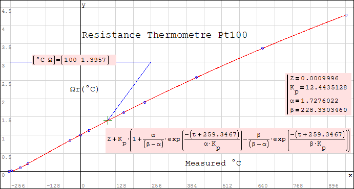

I sometimes put some additional descriptions on a diagram. I simply put there text fields. The problem is that they cannot be selected separately if there is a diagram below them. So after putting such description on a diagram I cannot move it any more as always diagram is selected.

You can have that, all commended from outside the plot.
Change yellow °C:=100 for °C:=200, see what happens on graph.
Inst_Type Pt100 Copy.sm (58.39 KiB) downloaded 1532 time(s).
