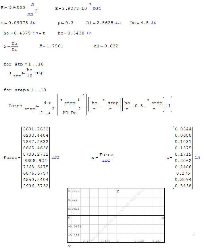

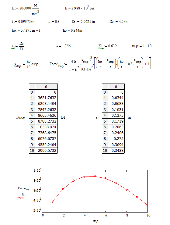

I try to plot a vector of results on a 2D graph to better visulize the results.
I would like to plot the vector values on the Y axis against the vector index on the X axis.
Here I post what I have done in MathCad and what I try in SMath.
issue 1: I need help in defining the plot value for SMath.
issue 2: I also need help in how to define two or more expressions within one for loop.

Thank you,
Jay

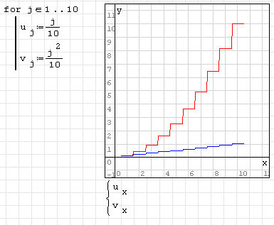

Thank you mkraska.
this is what I have now.
[albumimg]340[/albumimg]
By chance, is there any way to have the plot connect the data points with a line segment between points rather than having this stepped look? If so, it would easier to see the slope of the curve at the various divisions along the way.

#4 Posted: 1/21/2014 6:16:57 PM
Yes, of course. See the attached handbook pages.
Section 2D plots XY Plot Plugin.sm (58.09 KiB) downloaded 1431 time(s).
