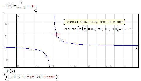

In fact it should not be necessary to define the search range of solutions. A search range is still defined in the general options, and sometimes you need to take a look before you run.
The discontinuity of the function at x = 1 creates some numerical problem.
As shown in the figure, trying different intervals are obtained unexpected values.
[albumimg]1436[/albumimg]

... always plot before solving, bracket the range wisely [1,2]

They both solve nicely. Search for the bracketing that
is compatible with the function(s)3.12345789 is typical.
It does not need to be so weird.
