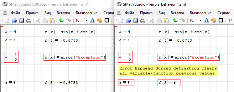

Almost forgot to highlight the following important change done in this release:
errors_behavior_1.sm (4.43 KiB) downloaded 2097 time(s).

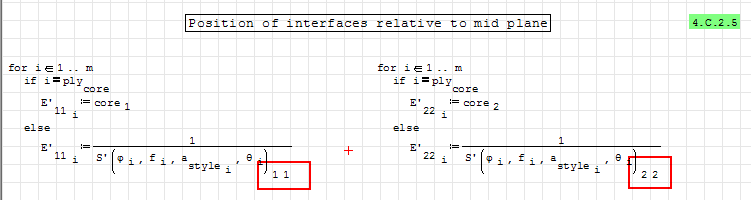

Hi Andrey
Very surprised that an error popped up in the latest build. Maybe also the one before, not sure.

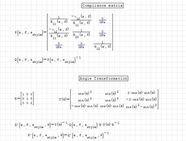

For your info, here is the S' definition
It seems that somehow these last two builds cannot find a value of the matrix coordinates indicated. It worked fine in .6484 from October, which I have gone back to. I can send you the file, but I would prefer to do so privately.
Love this program
Doug Schickler
Please send a worksheet to me so I could reproduce and fix this issue. E-mail is specifield into About dialog of SMath Studio.
Thank you for the report!

It seems that somehow these last two builds cannot find a value of the matrix coordinates indicated.It worked fine in .6484 from October, which I have gone back to.I can send you the file, but I would prefer to do so privately.
That it worked 6484, I doubt as it shows incorrectly dressed.
If you had a result => most probably erroneous.
On the setup "rotation*matrix", Smath [4356, 6179] displays an error message.
The rule Matrix*Rotation is universal, not commutative.
UnknownConfidential.sm (202.5 KiB) downloaded 2049 time(s).
Rotate Breather [4 Orientations].sm (1001.04 KiB) downloaded 1869 time(s).
