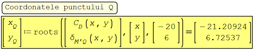

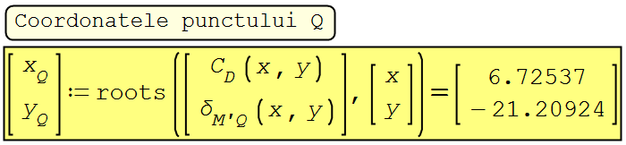

Trying to analytically solve a practical matter, I came to the sophistry in the attached file. Maybe someone knows what the causes are.Sophism.sm (29.3 KiB) downloaded 1633 time(s).

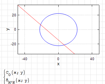

Good! You tell me that there are two solutions. I agree! But in this case the roots(2) function should mention them as such. In addition, the other intersection has coordinates x=-6.72537 and y=+21.20924. As a result, I (as a technician with a specialty other than mathematics) am confused. I understand that the other solution, I have to enter it from the console, in the case of a complicated and automated calculation?! My request is that you show me another method of calculation, which will offer me a solution automatically applicable to the case in question. Automatically, meaning without my intervention from the console.

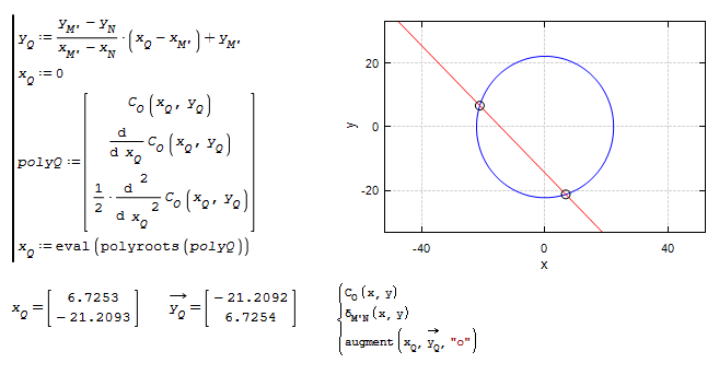

#9 Posted: 7/20/2023 4:42:03 PM
Hi Nicolas.
Not in this case, because SMath's solve is a numerical procedure. You can demand that of maple's solve() or Maxima's Solve() .
Not that fast ... the values for x are +6.7253 and -21.2093.
Although I think that overlord's solution shows the correct solution, this other method does not require initial values, since it makes use of the knowledge that the solution implies a quadratic equation, assuming that the line M'N is not vertical .
Sophism.sm (35.61 KiB) downloaded 1616 time(s).

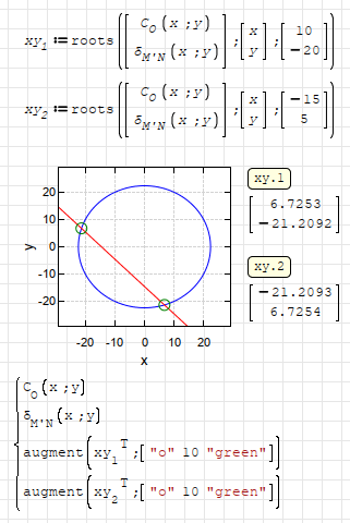

#11 Posted: 7/21/2023 8:31:00 AM
Nicolae Olaru
Nicolae Olaru
1 likes in 115 posts.
With a suitable pair of guess values, the problem will always indicate the pair of variables of the considered point, as can be seen in the attachment. Thanks for the guidance.Image_.png
