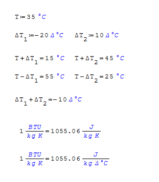

#3 Posted: 7/7/2014 12:13:26 PM

Finally we can use temperature changes now.
We could use temperature changes in the past as well ;-) if we decided to stick to what is physically correct: use absolute units for them.
The new Delta units are good in that they suggest the more sloppy users that there might be a difference to care about.
Yet a major source of errors with offset-temperature units remains: the surprisingly low priority of the unary minus operator.
Radovan Omorjan 7/8/2014 2:40:00 AM

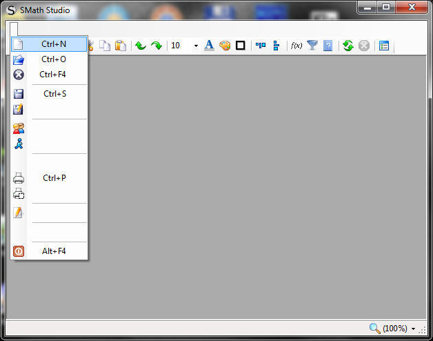

Did anyone experience this Unhandled exception when just trying to change the language interface. When ignoring it, then SMath appeared quite strange - see the picture. Also, see the video on this link changing languages problem (~5min long)
Here are the messages accompanied with this Unhandled Exception:
(x64 Win7)
Show Spoiler

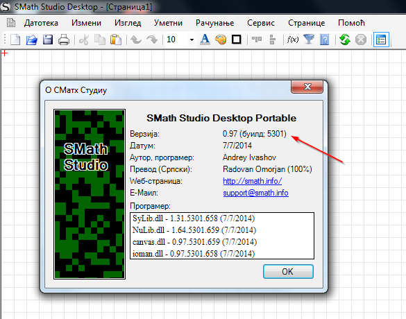

#11 Posted: 7/11/2014 9:28:48 AM
1418 likes in 2873 posts.
mhhh... I can't replicate your issue, I've tried with a lot of languages. Have you customized some units xml file?
#12 Posted: 7/11/2014 10:33:00 AM
325 likes in 2052 posts.
No, I did not do anything like this. Strange, but it happened to my home computer as well (x86 win7) and this nightly build. This happened when you I choose my languages (). It puzzled my more when I managed to use other languages but mine . On the other hand, I have no notification of the changes will have affect after restarting SMath when changing to Srpski or Српски contrary to other languages when I have this notification
Just to note, SMath portable by Martin (2014 06 21 SMath and Maxima) had no problems at all - see the picture.

#17 Posted: 7/11/2014 1:47:49 PM
2273 likes in 3737 posts.
Seems I found a problem. Radovan, please try to delete lang folder from C:\Users\[YOURPROFILE]\AppData\Roaming\SMath\extensions\.
Looks like it caused because this folder is not empty. I will handle it in next version.
Regards.
#18 Posted: 7/11/2014 2:18:07 PM
It seems you are right Andrey. The lang folder existed in Desktop extensions folder (guess which two files resisted there ) but not in the Portable extension one. I deleted the lang folder as you proposed and now it is all right . I might have figured out earlier, but I use Portable version more often.
