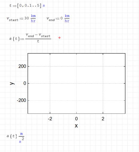

Hi All,
Could you direct me how to plot the function for some range?
plot in range.sm (5.55 KiB) downloaded 1151 time(s).

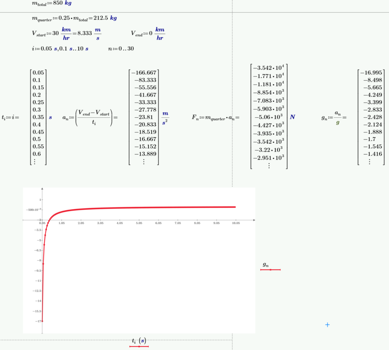

It looks like that both solution are not what I want to get - especially the first one...
Is there any possibility simply to plot the chart where on Y-axis I simply put the a(t) and on x-axis time??? Because this what you proposed it looks tricky and there is necessity to control units. Therefore it is not intuitive ( at least for me ;P )
Please check the photo below made by ptc mathcad. This what I want to do, is to write the same as the function and plot it using the SMath.
Mateusz
Mateusz

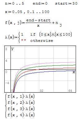

WrotePlease check the photo below made by ptc mathcad. This what I want to do, is to write the same as the function and plot it using the SMath.
If that plot is what you need, here is your answer.
With function, dots for values and new axes grid {0.05, -2}.
plotting_range.sm (10.98 KiB) downloaded 1118 time(s).
#8 Posted: 6/29/2021 10:03:41 AM
Hi Ber7,
This the acceleration during the breaking from 30km/h to zero in linear movement. Therefore in fact there is a(t)= v(t)/t. So: a_i= v_i / t_i and this is function where t is in some range, and i is the iterative change of time ie. the position of specific time. This what you wrote, is not the function of acceleration versus time.
Mateusz
Mateusz

@ Jean Giraud and @overload Thank you !
This is what I wanted to write in SMath!
Mateusz
Mateusz

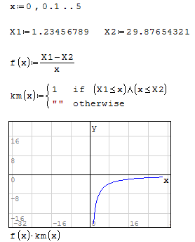

#11 Posted: 6/29/2021 11:17:05 AM
WroteThis is what I wanted to write in SMath !
Differently convenient plot ...
plotting_range [1].sm (11.48 KiB) downloaded 950 time(s).

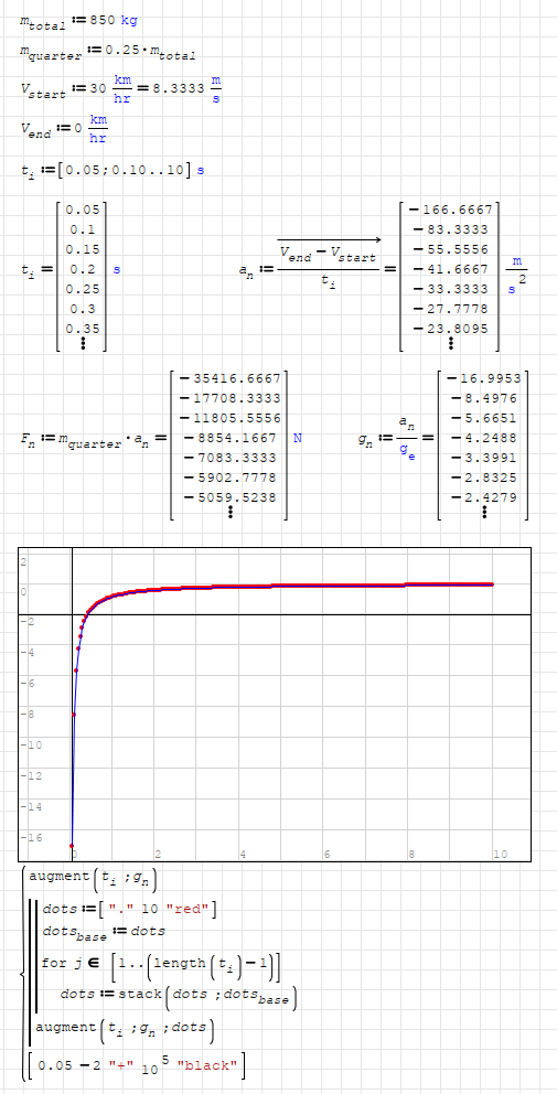

#12 Posted: 6/29/2021 2:18:24 PM
Hi. I agree with Ber7 that in absence of any other information the deceleration is constant. Physically that's means that the force of the breaks is constant too, which seems to be a good approximation, neglecting friction forces and some torque considerations about the wheels.
Yes it is: a(t) = constant for t in the interval 0 .. 10 s.

#13 Posted: 6/30/2021 8:24:19 AM
Wrote@ Jean Giraud and @ overlord Thank you !
At this point, we can populate conveniently
then, pass Thiele continued fraction
and inspect for the first/2nd derivative.
I doubt you can do that in Mathcad/PTC
