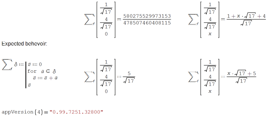

Hi. sum have an issue for symbolics evaluations.
You are correct, bug reproduced.
Definitely there are some issues.
Perhaps it is not only sum related too.

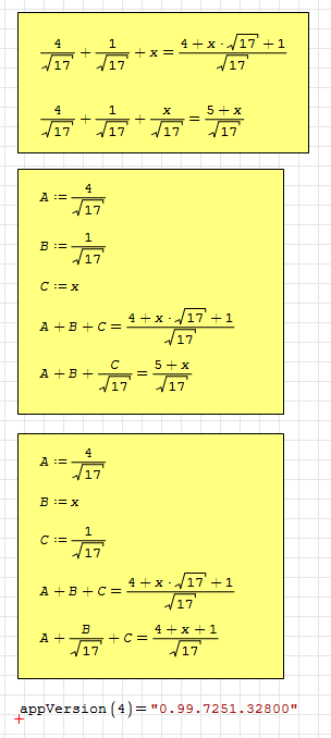

Hi. Thanks Overlord. I don't see these other problem. What make troubles for me is the fact that sum don't returns the symbolic values but numerical approximations, in this case for sqrt(17). I expect to see sum(vec) = 5/sqrt(17) instead the rational showed. I introduce the "x" value just for check if sum have some eval() function somewhere. But then ... ups, another issue simplifying 1+4.

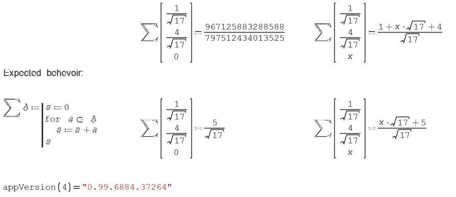

Hi. Some notes attached.
sum.sm (20 KiB) downloaded 68 time(s).
sum.pdf (66 KiB) downloaded 73 time(s).
