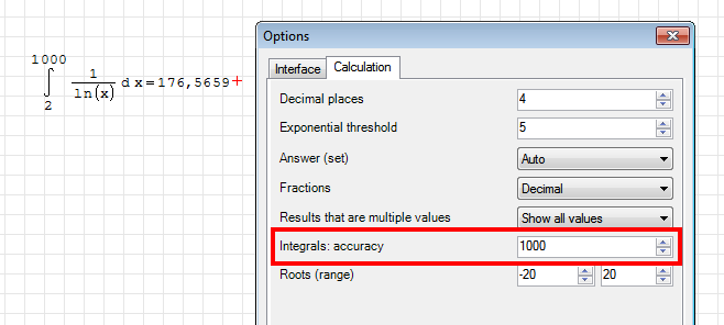

The integral of 1/(ln(x) with limits of x from 2 to 1000 does not agree with mathlab or maxima --
The numerical value of the following integration is off -- should be 176.56 and Smath gives 177.1
Any idea what could be the problem?

Hello [userlink]Joey Ooi[/userlink],
You have to set a better accuracy in the global options (tools >> options >> calculation)

Thank you for your quick and accurate response Davide.
It was very helpful indeed.

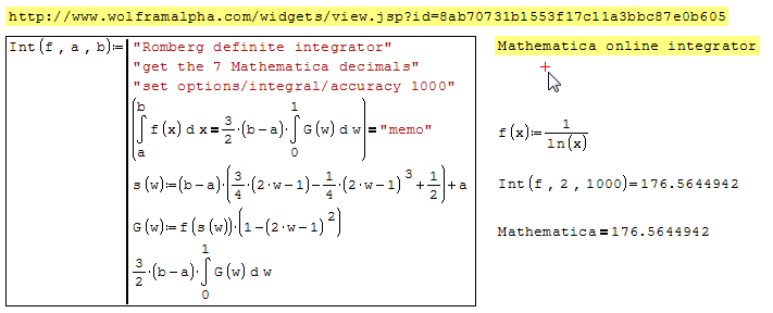

Smath Simpson iterative integrator is known to range from
exact [sometimes] to poor. Increasing accuracy is fine in
this example but will not converge in other instances like
in the Fourier Quantum double integral. You can rescue
your example using the attached Romberg.
Mathematica online integrator link added.
Integrate Mathematica.sm (9 KiB) downloaded 82 time(s).
#5 Posted: 5/23/2017 8:37:48 AM
983 likes in 6866 posts.
... revisit same work sheet for the 7 decimals !
Integrate Mathematica.sm (10 KiB) downloaded 75 time(s).
#6 Posted: 5/23/2017 8:53:58 AM
... like this
