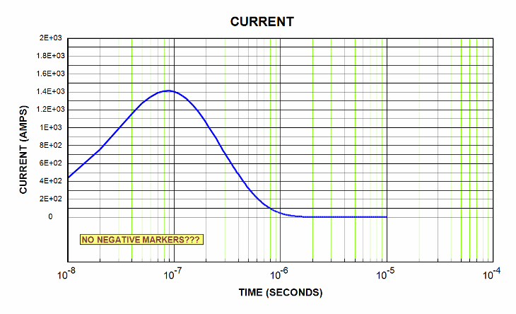

In the following ZedGraph, there are no major scaler markers in the negative y axis region. Have I missed an important parameter in setting up the graph?

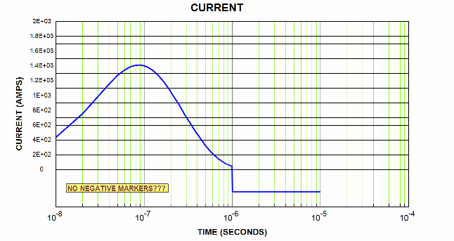

Hi Alvaro,
The vertical scale is set to linear.
I fixed the later time values to -300.

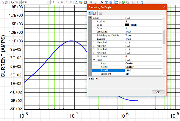

Oh, yes! You're right. I see "E" and think in logs. Please modify this parameter:

Hi Alvaro,
Thanks much!
ZedGraph is necessary for any log scales as far as I can tell. I has more options than I can keep track of. :>D
