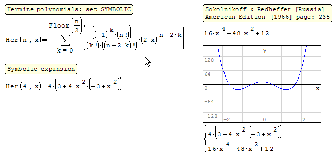

Smath does not "floor" n/2 in Hermite.
You can force: Floor(n/2)
Maths Schrodinger.sm (26.94 KiB) downloaded 1432 time(s).

That's interesting for the designers team.
"k" is very back to Hermite summation !
98.6103 breaks the chain code.
Other versions ???
Other versions ???

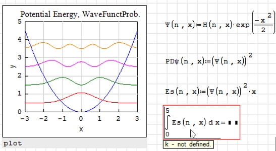

WroteIntegration error in 98.6103??
I've checked it.
The reason is that 0^0 is undefined in latest versions of SMath Studio.
So when program tries to calculate integral of initial equation, it has to calculate (2*x)^{n-k}, where x=0, n=4 and k=4.
That is why error occurred. Will think what can be done here.
Regards.

Andrey,
Please take note of another side of this problem: the error message "k - not defined" is completely irrelevant to the real cause of the error. In general, in SMath it's too often that the correct error message isn't propagated from the code that knows what has actually happened to the UI.
While passing through exception handlers, the message could get modified. If it's impossible to choose the most relevant place where the problem may be explained best, I suggest to keep all the messages from the most low level in a hierarchical message, to present the user most complete information. There could be an UI option that controls this behaviour.
Could you please put this to your schedule?

WrotePlease take note of another side of this problem
Good approach in theory, but not applicable in real life (at least in current real life
0^0 error happens on sum() function processing and not actually means anything for int() who initiated calculation. int() decides that its body cannot be calculated on first attempt and simply eats exception to return int() itself (with all its body) for further actions. But the next action is numeric calculation, which proceeded by numeric engine which knows nothing about summation and integration, so it just stumbles on the first undefined variable (k) and throws this error to user.
You'll say "bad design"? Yes, most likely. But it cannot be fixed fast and simple... unfortunately.
Regards.

#9 Posted: 10/5/2016 11:59:46 AM
Fixed.
