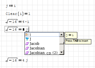

You can't totally remove i assign.
Or swap i with j via editing Constants.xml.
It is hard-embedded to smath code.
Clear(i) gives 1, which falsely results as it worked.
But it won't actually be removed by Clear().
However, you can assign sqrt(-1) or i to j.
Results placeholder can be edited with j.
And you can reassign you i result to j.

Actually you can, but j won't constantly swap with i.
Every worksheet should have j:sqrt(-1) at top.
i will have what you assigned. variable, real, etc.
But when you calculate something which results as sqrt(-1),
it will considered as i again.
While i still has another value,
calculation still gives it as sqrt(-1).
But when you directly call i,
it will have what you assigned.

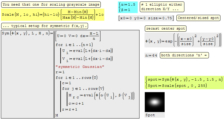

As well, 'i,j' are largely used by Smath original Designers
and the Smath Community as rows/cols indices.

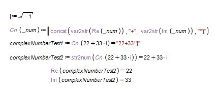

As stated, you cannot replace 'i' as the Special Variable. However, there are some trick you can use (depending on your purposes):
First: define 'j as the imaginary unit; copy and paste the following:
Quote
'j:sqrt(-1)
Next: define a function, similiar to this:
Cn(_num):line(concat(var2str(Re(_num)),"\002B\",var2str(Im(_num)),"\002A\\0027\j",1,1)
With this defined at the top of your sheet, you can display your number (as a string) in the syntax you desire. To use it as a mathematical expression, just use the str2num() function to convert it into math. NOTE: for this to 'work,' you need to have the 'Custom Functions' plugin installed:
May this be of Good Help!
