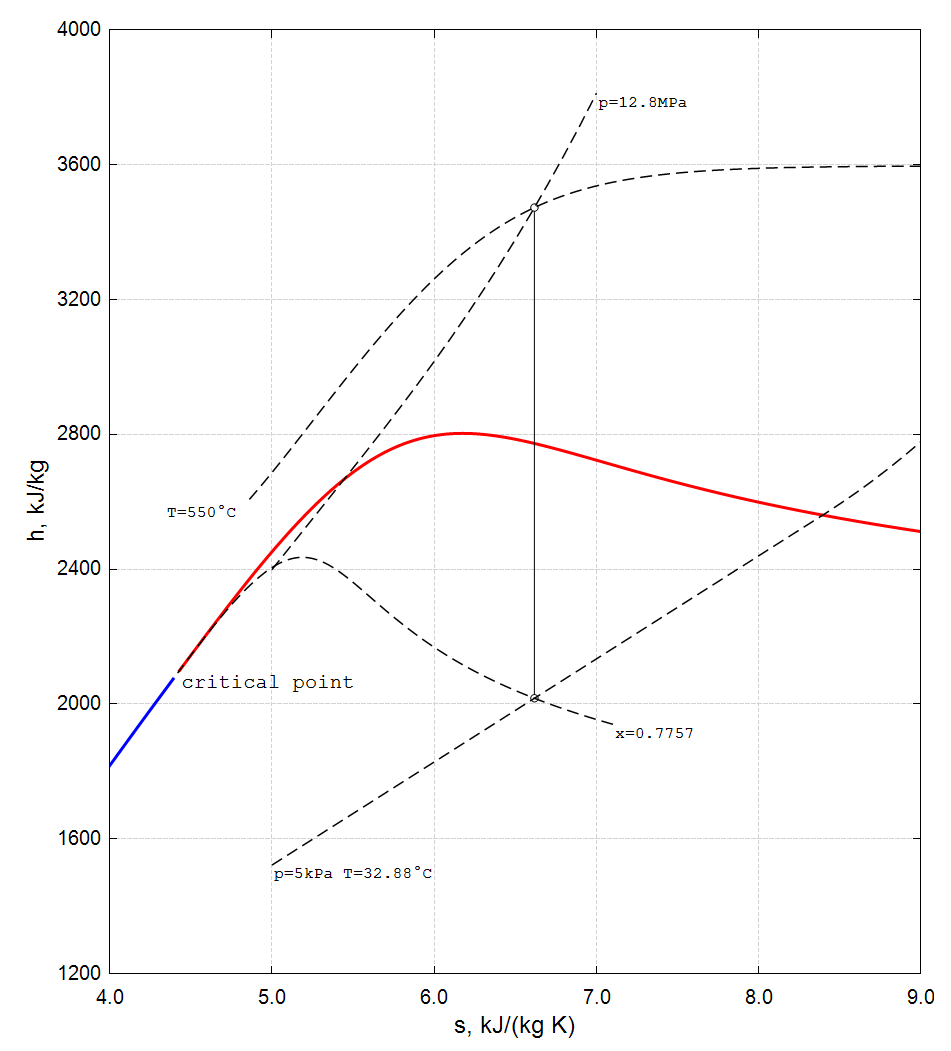

Hi. Comparing the result with the other water compound implementation.
h-s-diagram-Steam.sm (28.14 KiB) downloaded 1443 time(s).

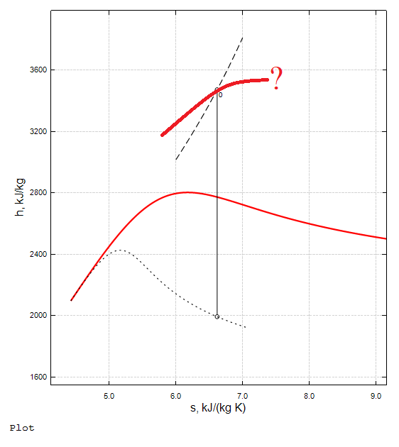

My solution. Now I'm thinking about isochore and second isotherm.
h-s-diagram-Steam.sm (31.02 KiB) downloaded 1520 time(s).

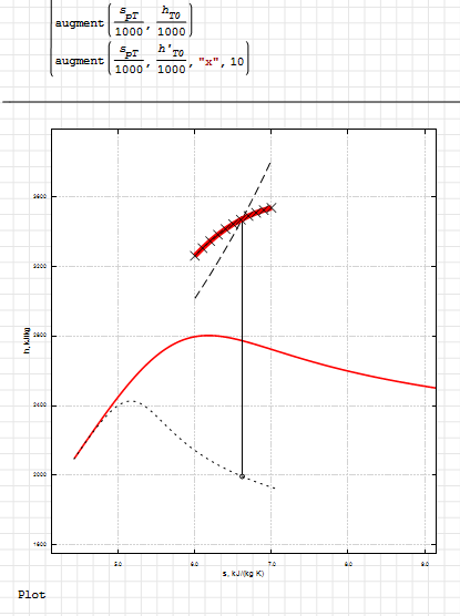

With Mathcad Prime and WaterSteamPro

New version
h-s-diagram-Steam.sm (41.67 KiB) downloaded 1465 time(s).
