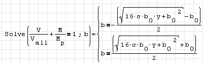

#104 Posted: 4/18/2014 6:37:52 PM
Hi mkraska,
I am getting to use maxima plugin a little bit more and ran in a problem very similar to
http://en.smath.info/forum/yaf_postsm12822_Evaluate-expression-for-a-variable-s--set-to-a-number.aspx#post12822
When I pass to Maxima an expression (using Maxima()) with undefined variables to solve it symbolically it does not seem to work. I have created Maxima workbook to confirm that what I am trying to do is achievable using maxima.
Any ideas?
Screenshot and Smath workbook are attached.
Thanks!

#105 Posted: 4/18/2014 7:00:08 PM
#106 Posted: 4/18/2014 9:39:35 PM
mkraska,
That explains why solve() function did not work, however it does not explain why Maxima(solve())= function did not work - it should have passed solve() to maxima in which solve() is correct syntax.
Thank you for your help!!!

WroteThat explains why solve() function did not work, however it does not explain why Maxima(solve())= function did not work - it should have passed solve() to maxima in which solve() is correct syntax.
Maxima() just like any other function in the Maxima plugin translates the arguments only after SMath preprocessing, i.e. substituting all known symbolic expressions and executing all known functions. If a function is not smart enough to return itself if this evaluation fails, then the preprocessing throws an error. In the given case, solve() should return itself if evaluated symbolically.
Switching off preprocessing (you can do that in the maxima debugging window) is not an option, unless you want the arguments of solve() being transferred to Maxima verbatim.

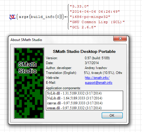

Here is another portable SMath with Maxima.
- unzip the file wherever you want (space requirement 140 MB
- launch the executable in SMath\2014 04 17 SMath 0.97.5189 Portable
You also can run wxMaxima in SMath\Maxima-5.33.0.1\wxMaxima
As a test you might run the attached file. The package contains an experimental version of the Maxima plugin, some of the features (in particular the file format of plot regions) may change.
There are stability issues with the draw functions. They can crash Maxima and sometimes SMath if their input is not defined.
Fit.sm (21.46 KiB) downloaded 1567 time(s).

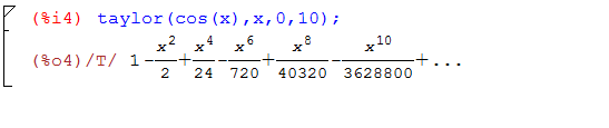

I've just restarted SMath after a break of a couple of years and am finding the Maxima plugin is the best thing in SMath since I last used it.
I do however have a minor problem. When doing a taylor expansion, the expression displayed by SMath is being factorised. This is quite annoying for me and I would like to know if there is a way to display the expansion is the standard format as displayed by Maxima. See below.
SMATH output
Maxima Output
SMATH output
Maxima Output
#118 Posted: 5/6/2014 12:49:08 PM
SMath Optimization should be suppressed when using Maxima plugin. Right click on the Maxima region and choose Optiization|None
[MATH=eng]Maxima(taylor(g(x),x,0,10))=1-{x^2}/2+{x^4}/24-{x^6}/720+{x^8}/40320-{x^10}/3628800[/MATH]
patel75 5/7/2014 3:51:00 AM

#120 Posted: 5/28/2014 3:54:41 AM
Hello Martin,
I can not figured out what is going on here by looking at the log file. Please look at the picture and the attached file. If I use numbers inside distrib package functions I have the result, but if I use variables - problems arise. Am I missing something here?
