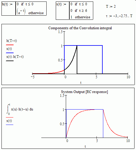

#174 Posted: 4/30/2016 11:39:20 AM
983 likes in 6866 posts.
Forum dwellers, is there anyone among us who can take on maintaining the plugin? You don't necessarily need to know any programming language - using debug of Visual studio you can learn everything what the plugin does and then, hopefully, fix it. Being a skilled programmer and knowing a language just enough to make things work are two very different things.
Besides inserting image from file, I see no need for plugins except those that make
Smath f(x) menu work. Too many "toyers" and not enough "users" in the Smath community.
For instance: what's the need for a glorious text box ? The prime use of a text box is
to front end a project with an abstract [~ dozen lines], as bare as possible.
I just need more working maths for project as well as Edu. implicit of their
companion plugins... plugins maths, that's what I mean, like this one.
Just make Smath understand something in there.
#175 Posted: 4/30/2016 11:41:35 AM
... here is.
