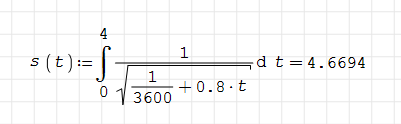

When trying to solve the following definite integral using Smath, the result returned by Smath is incorrect. Can somebody help me, please?
int(1/sqrt((1/3600)+(0.8*t)),t,0,4)

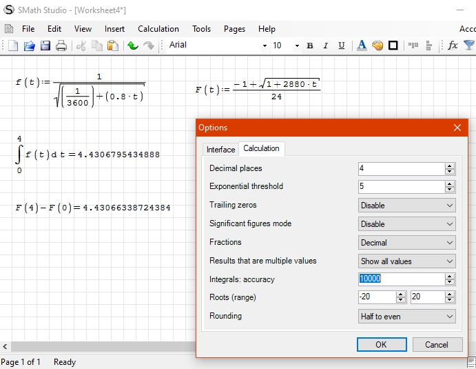

#2 Posted: 4/22/2021 1:00:20 AM
Hi. It's a numeric issue of the numerical procedure for integration. Try to change "Integral accuracy" option ... from 100 to 10000. Ok, that make it very slow.
Chau.
#3 Posted: 4/22/2021 1:50:45 AM
Victor
Victor
0 likes in 4 posts.
Chau.
It works! Thank you very much, Alvaro! Regards!

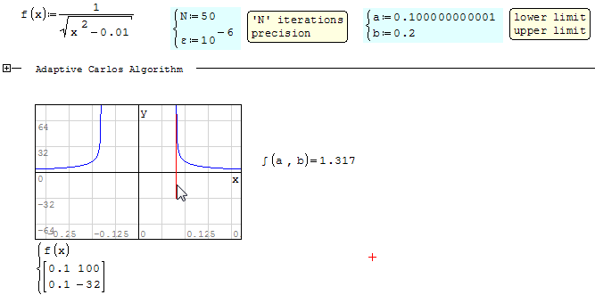

#4 Posted: 4/22/2021 8:34:00 AM
1. Always plot the integrand
2. Try Wolfram Alpha
3. Use Smath Carlos ... hyperfast/accurate
Page17 Integrate Carlos.sm (84.63 KiB) downloaded 1776 time(s).

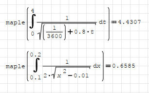

#6 Posted: 4/22/2021 8:20:04 PM
598 likes in 1,380 posts.
I have the same problem again with this definite integral. I have tried to change the "Integral accuracy" but it hasn't worked. Can you help me please? Thank you.
int(1/(2*sqrt(x^2-0.01)),x,0.1,0.2)
Try to use maple or maxima plugin.

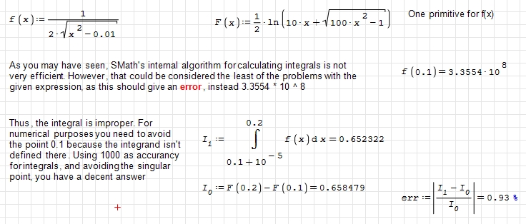

#8 Posted: 4/22/2021 10:14:32 PM
Answer and result are via in post # 4 above.
#9 Posted: 4/22/2021 11:11:13 PM
Hi. The problem with your example, now, isn't the bad integration, it's that it give you a number, not a an error. Notice that the integrand isn't continue at x = 0.1, it's undefined or infinity, because you divide by zero there.
As Overlord points, you can use Maple or Maxima for handle this kind of problems.
ImproperIntegral.sm (9.46 KiB) downloaded 1473 time(s).
sergio 4/23/2021 5:05:00 AM

#11 Posted: 4/23/2021 10:08:48 AM
Page17 Integrate Carlos.sm (88.08 KiB) downloaded 1724 time(s).
In some instances, Adaptive is of no profit, but not detrimental.
