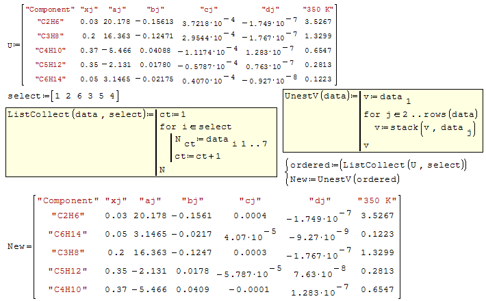

#2 Posted: 5/16/2023 6:52:30 PM
Does it make sense to have the system ordered 'x ascending' ?
Javier Ochoa 5/16/2023 7:16:00 PM
#3 Posted: 5/16/2023 7:18:44 PM
Javier Ochoa
Javier Ochoa
3 likes in 26 posts.
Hi Jean,
I was not aware of putting things sorted by x ascending, but it looks good.
