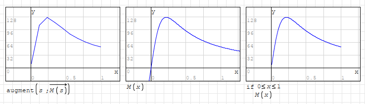

If you just wrote M(s) then your plot doesn't have enough points.
Both x and y points should be written if you are plotting them.
You can achieve this by augmenting x and y points.
Or you can plot directly by M(x) which plot region will use x for x values.
Result of your M() function will be used for y values.
You can limit plotting by simple if() or cases() function.
1.sm (15.43 KiB) downloaded 1269 time(s).

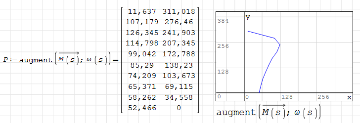

How I see it: I have ten values of M(s) and ω(s) and I need a graph where the Y axis is ω and X is M . I don't understand why the graph is not being plotted in this case. After all, there is everything for plotting. I posted an example in a file.
Why can't I just output the value of M(s), and for this I need to output this value with an arrow at the top?
1.sm (14.81 KiB) downloaded 1278 time(s).

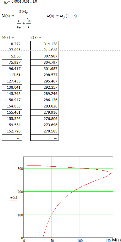

And I have mathcad example:
Meh_Har_AD.xmcd (81.1 KiB) downloaded 1258 time(s).

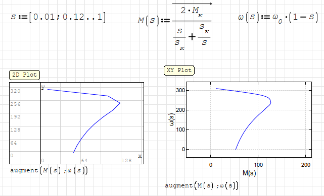

#5 Posted: 2/15/2023 3:57:36 AM
TopUser2000 2/15/2023 4:33:00 AM

Oh, thanks friend). That's what I need.
can someone explain to me why I have to use a vector quantity when outputting the value of M(s)? Otherwise, Smath complains about a non-square matrix.

The vectorize function enforces elementwise operation if vector valued variables are involved.
The linear operation defining omega is elementwise by default, whereas dividing by s would be understood as a matrix operation (inversion) by default.

I tried to install this plugin, but I still didn't figure out how to rename the axes
Double click to XY Plot canvas, it will open a new window for you to change its setting.
You can also Right click>Format to plot area, it will do the same as double clicking.
There you can find a section Labels. Change x-y labels to M(s) and ω(s).
XY Plot contains a lot of options there. Check them and try them.
1.sm (16.51 KiB) downloaded 1271 time(s).

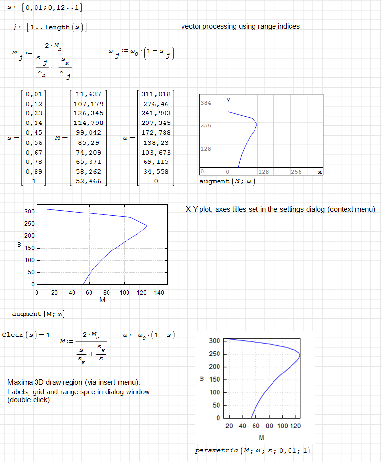

#12 Posted: 2/16/2023 5:55:33 PM
Vectorize-free versions, one with range indices and one with parametric plot.
1_Kr.sm (30.92 KiB) downloaded 1241 time(s).
TopUser2000 2/23/2023 1:01:00 PM, sergio 2/17/2023 6:29:00 AM
