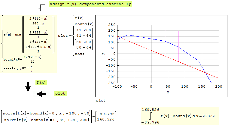

#6 Posted: 9/28/2019 6:35:33 PM
983 likes in 6866 posts.
... Dichotomy added for solving in the complex region.
filling the loft added.
2D Plot Discontinuous [min(,)].sm (44 KiB) downloaded 77 time(s).

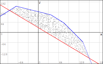

#8 Posted: 10/1/2019 8:35:03 AM
but how do you set your graph axis
1. Dispose the plot from plotting using Smath @ QuickPlot
zoom, shift left/right, up/down ...
2. Plot on the X_Y, set the X ± limits, Y ± limits.
3. plot ... 4. specify the traces from "list"
As simple as explained, no sweat ! ... Last plot.
2D Plot Discontinuous [min(,)].sm (44 KiB) downloaded 113 time(s).
