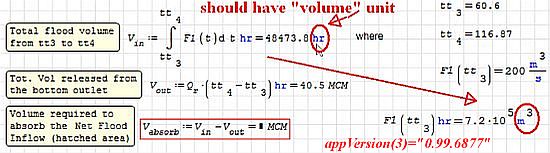

Thank you Andrey for the latest SS 0.99.6877.
However, I observe a problem in integrating a user defined function with units.
The attached SS document (and all similar docs) worked fine in all previous SS versions without any issue.
Malwala Reservoir Flood Capacity Estimation-Simple.sm (249.34 KiB) downloaded 1283 time(s).

Thank you!
For some reason I had no automated test with such example (integral with units) and that is why I didn't catch this error before the latest beta release.
Will add example to tests and make a fix asap.
Thanks for the report!

Thank you Andrey for the fix.
