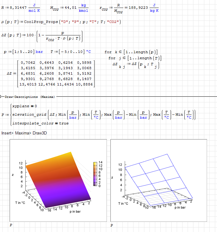

i would like to create 3d plot of compresibility with p and T as axis. How can i do that?

Hi. This is a way.
Z-CO2.sm (16.56 KiB) downloaded 776 time(s).

i would like to use char3D or Maxima plot. Is the procedure same?
#4 Posted: 12/14/2025 12:32:34 PM
Hi Tomas. I assume so. And also in maple, dislin, and others. But I'm not skilled enough in those methods to show you the most effective way to use them.

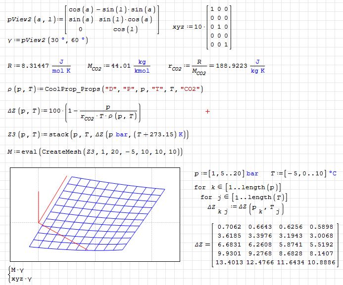

#6 Posted: 12/17/2025 10:17:20 PM
The plots can be rotated with the mouse, yet there is a considerable time lag.
3d.sm (219.19 KiB) downloaded 759 time(s).
