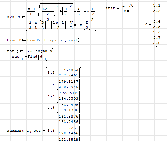

#3 Posted: 6/1/2017 2:54:16 PM
983 likes in 6866 posts.
Thanks Davide,
In the mean time: I did, a bit differently.
Next => collect for the plot.
