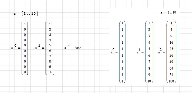

How can I equate power of range to the following? How can we solve this error, anything power should be 1.
When a range is square, the return answer is total of square value.
Page5.sm (9.89 KiB) downloaded 1193 time(s).

As you evaluate over a vector, use the vectorize operator.

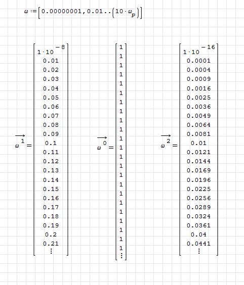

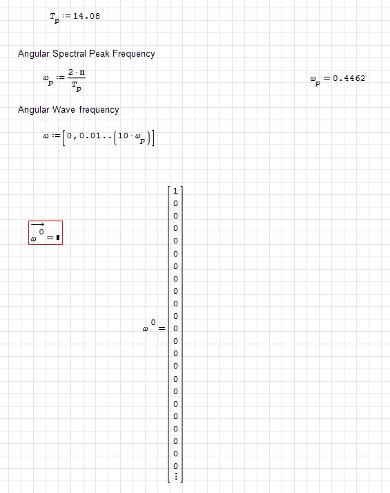

I tried to vectorize the following. What have I done wrong?
Page6.sm (5.22 KiB) downloaded 1269 time(s).
#4 Posted: 1/21/2021 4:40:37 PM
Hi. There the problem is 0^0, it is undefined, at least in SMath environment, and probably it's the best choice: return an error if appear. That for the vectorization. About w^0, without vectorization, seems that SMath try to do a scalar product, like in w^2. Remember that a^0 = 1 for a <> 0 it's by definition, not by any theorem.

Delete thehat are you trying to do? Everything is defined, yet, you have a range for the answer. Are you looking to plot?

I just need to put a very small values instead of zero.
