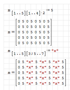

- SS-3513: It is allowed now to use vector-based expressions as indexes for matrix definition;

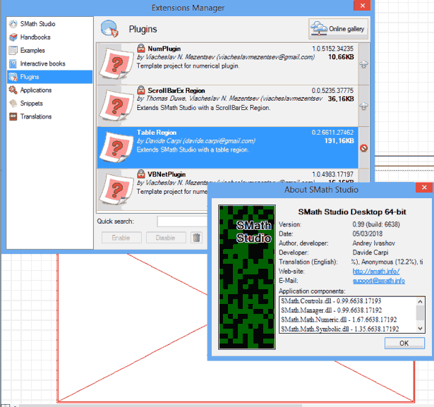

Fixed (please update a plug-in). Thank you!

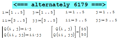

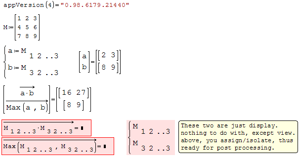

WroteA bug in functionality of vectorize() was introduced between 0.99.6617 and 0.99.6638
That it was introduced between 6617 & 6638, that is surprising ?
Even if it did work, to me, it is not correct because it will cause
something wrong sooner or later, because to reflexive in the
calculation kernel ... Murphy's law. I have experimented disastrous
situations [crash ... push the button to stop].
Occasionally, to isolate, you have to spool to file.
Cheers Alex ... Jean
