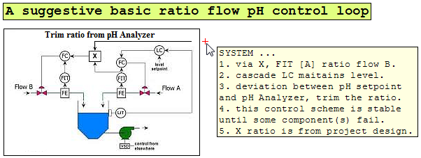

This short study is just for lecture.
Suggestive of how to tackle/conduct a real project.
Thanks for the gracious companionship Smath/Maple.
Enjoy/comment ... Jean
