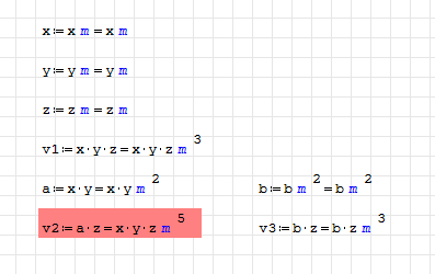

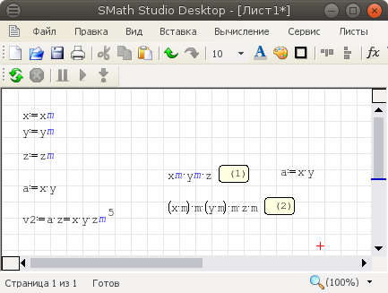

First post, please be gentle.
I tried to attach a screen grab that illustrates my question, hope it works!
x, y and z are symbolic variables, I multiplied by unit 'm'
x,y and z evaluate symbolically is as expected.
v1 is as expected, i.e. a cube with unit m³
a is area of rectangle xy and unit is as expected 'm²'
for v2, symbolic evaluation is as expected x.y.z, but the unit is not as expected (m^5 instead of m³ )
v3 is a trial with b as a tester in 'm²' it works as expected
I arrived here from trying to do a much more complicated symbolic evaluation with other units and getting odd results. Maybe I am trying to do something that is not supported?
Any help greatly appreciated!
I suppose my question is "why isn't the v2 result the the same as v1 and v3? and is this supposed to work?"
smath studio version 0.98(build:6103)
Thanks, Richard

#2 Posted: 9/24/2016 9:09:34 AM
It seems that you have found a bug.

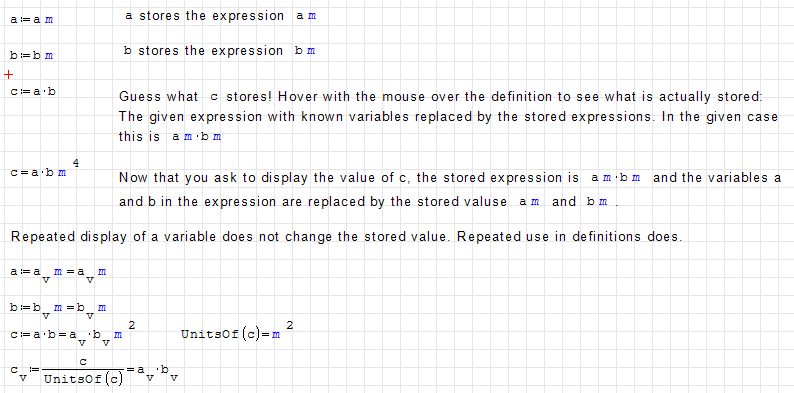

With pencil and paper math, it would be plain wrong to identify a quantity with the same quantity times a unit.
This is not better than saying i=i+1 and then complaining that the value of i changes whenever that expression is evaluated.
Correct would be to use separate variables for a quantity and it's numeric value, say x:x0*'m with x0 being a dimensionless number and x a physical quantity.
The behaviour observed is not a bug, just a consequence of inappropriately using recursive definitions.

#7 Posted: 9/25/2016 7:47:38 AM
Hi Martin,
Thanks for taking the time to share your thoughts.

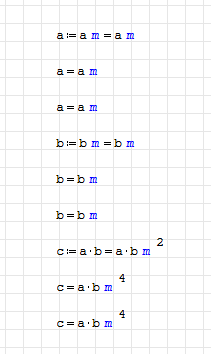

I already tried using an auxilary variable for symbolic definition and then defining a second one with the unit as you suggest (see post 6).
The problem with this workaround is that subsequent calculations are defined in terms of x,y,z and evaluated in terms of a,b,c which seems to me to be clumsy / non elegant and confusing for anyone that I might show the calculations to, so I suggest this is not 'correct', certainly not ideal. Maybe it is the case that the correct way doesn't exist yet but that's ok.
What I am looking for is a way to define a symbolic variable as having a unit without it relying on other auxilary variables, maybe this is not possible?
Further, consider the example below, multiple evaluations of a and b do not result in m², m³ etc, however, a second evaluation of c does but further repeated evaluations do not.
Also, who is 'complaining' and 'bashing'?
Richard

#8 Posted: 9/25/2016 1:03:57 PM
WroteHi Martin,
I think a correct way exists, but not under the condition that the quantity is not the same as the quantity divided by a unit. Just as a vector should not be represented by the same name as it's co-ordinates. A unit is a base in the linear space of the quantities of a certain physical dimension. Quantity is a number times a unit. In that sense the number is the co-ordinate of a vector. Quantity and co-ordinate can be unknown but for a certain variable name you have to choose. According to DIN standard, any quantity can be written as a={a}[a], where [a] is the unit of a and {a} is the numerical value. If you use some modifier like the text index v instead of the curly braces, you can represent that in SMath Studio as well. [a] can be written as UnitsOf(a).
What is bad with the approach in the lower part of the attachment?
As to the remarks: they referred to using the term "bug" further up in the topic history. However, sometimes it is indeed hard to tell a bug from wrong usage, because there is no official document specifying the SMath design intent. Thus all we have is our observations and some assumptions on what the design intent might be. Some years ago one of the SMath survival rules was "Don't use symbolic optimization". Currently, I am investigating if that rule still applies. My impression is that it might be possible to replace it by a set of rules for symbolic optimization. Yet, the challenge is to write clear and easy rules.
units5.sm (9.22 KiB) downloaded 1161 time(s).

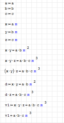

As pointed out by Martin, the general correct way should be to name the "object" differently from how it is named the dimensionless value (f.e. consider "a" the edge's length in meters of a rectangular prism and "x" his length divided by meters; "d" will be the area of a side in square meters, "v" the volume in cubic meters):
![2016-09-25 19_33_52-SMath Studio Desktop - [symbolic.sm].png](/en-US/files/Download/pAHaAC/2016-09-25-19_33_52-SMath-Studio-Desktop---[symbolic.sm].png)
However you can still use your syntax, if you want, just pay attention on the order of definitions.
When you define (:=) something:
In your example "d" was defined after x and y -> the values are stored (x*'m for x and y*'m for y; hold the mouse over d); then you ask to display a result for d * z -> (x*'m*y*'m)*z -> according on what is defined on the canvas: x is x*'m, y is y*'m, z is z*'m -> x*y*z*'m^5
If you define d:x*y before defining x and y, d will contains just x*y, then further evaluations will replace these unknowns with their values, if available:
![2016-09-25 19_52_01-SMath Studio Desktop - [symbolic.sm_].png](/en-US/files/Download/orp2V5/2016-09-25-19_52_01-SMath-Studio-Desktop---[symbolic.sm_].png)
Another way is to use a procedure - line(...); since it is not evaluated at his definition, his content will be replaced only when will be evaluated (when it is used on the RHS to define a variable or you ask for a result):
![2016-09-25 19_57_36-SMath Studio Desktop - [symbolic.sm_].png](/en-US/files/Download/7NHXKv/2016-09-25-19_57_36-SMath-Studio-Desktop---[symbolic.sm_].png)
- If something was already defined (:=) the value is stored (see IfDefined(...) or the dynamic assistance to check if it was already defined)); the value is anything on the Right Hand Side (doesn't matter if has a numerical value or contains unknowns);
- If something is not yet defined, the name is stored;
