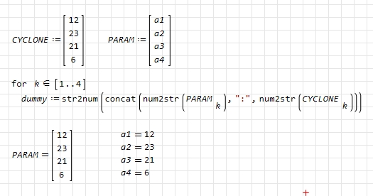

#4 Posted: 3/5/2021 10:57:24 AM
churichuro
churichuro
28 likes in 79 posts.
tal vez así :
CONSULTA1.sm (5 KiB) downloaded 56 time(s).
pero parece que se modifica PARAM
sergio 3/5/2021 11:07:00 AM

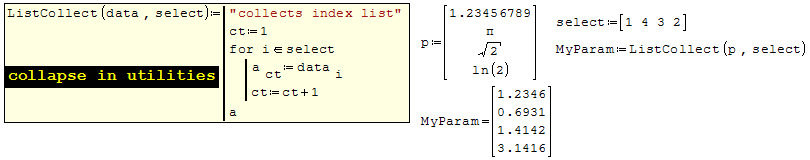

#5 Posted: 3/5/2021 12:05:05 PM
983 likes in 6866 posts.
Get + from much less.
ListCollect(■,■) has no limit in construction.
