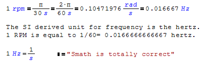

#9 Posted: 9/7/2016 2:08:42 PM
1,443 likes in 2,935 posts.
1 rpm = 1 rev/min = 1/60 rev/sec
And it is exactly how it is defined in SMath
But 1 revolution is equal to 360° (2pi)
If you don't need relationships with the angles (the 2pi factor), simply redefine rpm

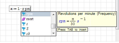

I think that the root of the problem is that rpm is not an SI unit. Therefore you can consider it to be either a unit of frequency (of rotation) or a unit of angular speed.
If you consider it to be a unit of frequency (angular frequency) then 1 rpm = 1/60 Hz follows immediately. If not then you get the 2*pi factor (what sMath Studio does).
I have been looking for some information online and in most of the webpages I found they consider it to be a unit of frequency. Which makes sense to me since frequency is event for unit of time and rpm is revolution (event) for unit of time (minute).
By the way, even sMath Studio (once you hover over the unit) displays it as a frequency (not angular velocity).
Christopher Bietz 9/9/2016 11:10:00 AM
#16 Posted: 9/9/2016 9:24:11 AM
Good point indeed. This should be changed. It also applies to some other units. This can be seen best in the insert unit dialog. There, some categories are missing:
angular velocity
angle
The angular units currently are categorized as dimensionless.
Filed as SS 2395
#17 Posted: 9/9/2016 10:20:41 PM
To deplease previous comments, Smath is totally correct
in this thread. It just happened that some i... at the
SI system decided not to count rpm on fingers but on
fractional fingers. End of it, Smath OK !
