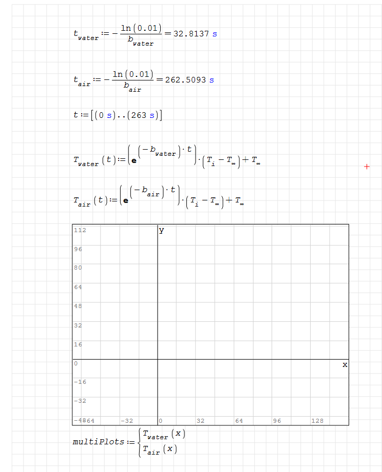

I am trying to plot two temperature curves governed by two equations with one variable that changes between them and one variable that goes from an interval of 0 seconds to 263 seconds. The plot window accepts the equations, but does not plot them. Additionally, when trying to get either equation to solve, it gives an error "cannot calculate". Which is quite odd, running through it on my calculator the equations work fine.
My only lead to what is going on, is perhaps the formatting is off and SMath doesn't understand it? I tried removing all the .waters and .airs, but that didn't work. I tried removing the time units, didn't work. Tried giving time just one value, did not work. I tried removing the (x) and (t) from the equation, did not work. I followed exactly what the wiki said to do, so I am not sure why I can't get these to plots. Don't really want to have to switch over to excel to get the graphs... Attached is a screenshot of the issue and the equations.
Anyone have any ideas?

Too many complains in there ...
better attach the *.sm document for doctoring.
Try this ...t(x):=-ln(0.01)/x ... plot

Hi Albedo. Try to plot T(x*'s)

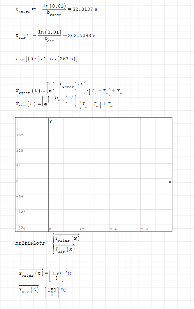

Tried to plot T(x*'s), no luck either. Attached is the .SM file if you want to try experimenting with it.Worksheet2.sm (7 KiB) downloaded 72 time(s).
EDIT: Found a previous post of somebody struggling to get a range variable to calculate, the solution was to vectorize the equation after to get it to form a matrix. This works and gives me the correct temperature value, but it still will not plot the functions.
Hi. Try to resize the plot too.

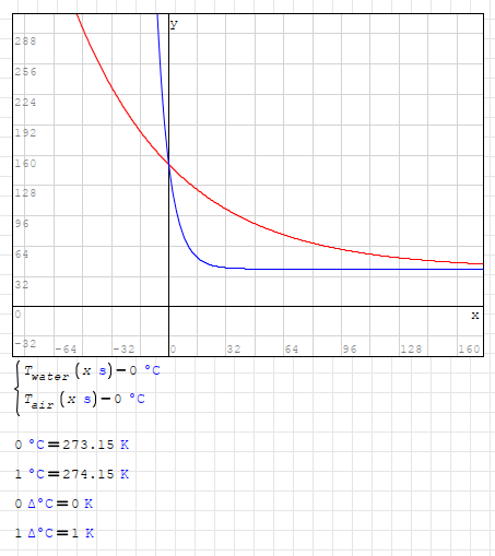

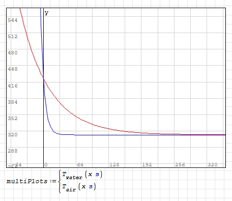

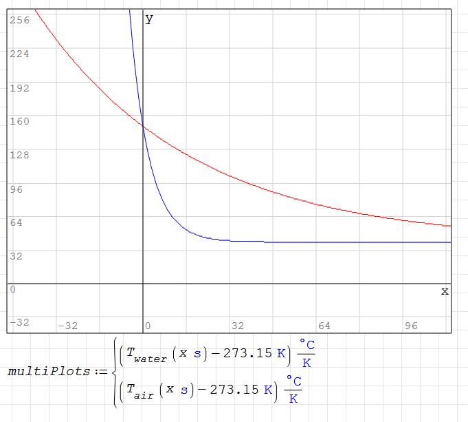

Awesome, thanks! That is exactly what I wanted. One last thing, is there a way to change the units for the y-axis? It is in Kelvin but I may want to change it to degrees C instead.
#7 Posted: 10/10/2022 6:51:21 AM
Oscar Campo
Oscar Campo
124 likes in 298 posts.

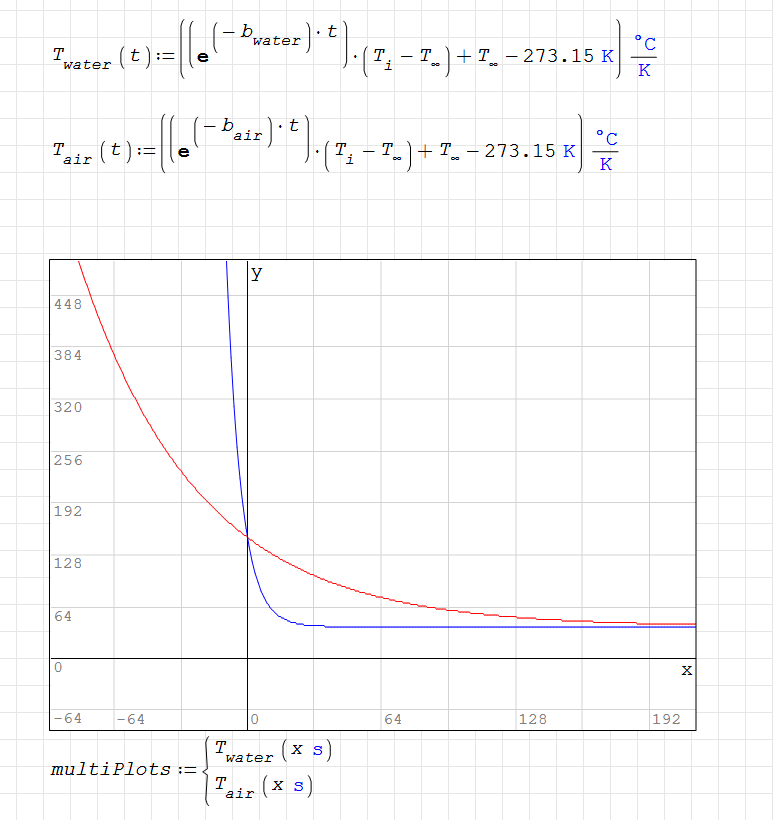

You have these options:
Manipulate units in plot definition
Or...manipulate units in the function definition:
Oscar

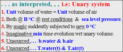

#8 Posted: 10/10/2022 9:41:41 AM
983 likes in 6866 posts.
... as interpreted to be commented.
Cheers ... Jean.
Worksheet2 as interpreted.sm (18 KiB) downloaded 69 time(s).
#9 Posted: 10/10/2022 5:06:00 PM
554 likes in 1333 posts.
You can simply write as in plot below.
Just a reminder, since you are working with temperatures.
Temperature unit handling is different in SMath.
Addition of temperatures beside Kelvin should be done with delta units.
Otherwise, it will cause some unwanted complications.
3 users liked this post
Alvaro Diaz Falconi 10/11/2022 1:42:00 AM, sergio 10/11/2022 5:05:00 AM, Oscar Campo 10/11/2022 7:28:00 AM
#10 Posted: 10/11/2022 9:02:31 AM
As given, your project is not traceable.
It may be correct, but not for publishing.
Cheers ... Jean ... welcome for more.
Worksheet2 as interpreted.sm (34 KiB) downloaded 67 time(s).
