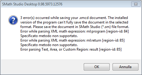

In the method
public static Term[] PrefixToPostfix(Term[] value)
I found that an exeption is thrown while parsing the UnitOperator; skipping this (that is just a workaround, there's an inconsistence to fix somewhere), it loads more functions but there are some errors in the last 2 xmcd regions (unrecognized tags ml:program and ml:return)
The patch on the UnitOperator seems that helps even here: http://en.smath.info/forum/yaf_postsm33083_Mathcad-file-import.aspx#post33083 (still missing the conversion for the "plot" region)
Reported as SS-2341

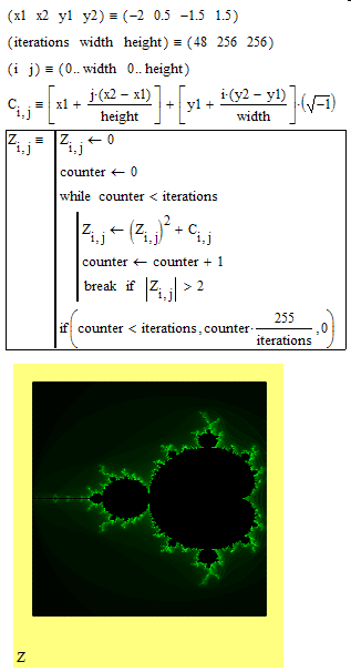

Mathcad/Mathsoft and "Numerical Recipes" origin in the same period [mid 1980].
Many of the Mathcad powerful solvers are practical and most advanced in compacted
form ... Given/Minerr [QuasiNewton, ConjugateGradient, Levenberg-Marquardt,
user], Genfit had very little use but is the core algorithm in the GenfitMatrix
developped by Robert for the Padé rational fraction [a piece of gold].
Given/Find [Maximise/Minimise] c/w symbolic expansion.
The 'root' is also very powerful [Brent, Ridder].
Mathcad gurus of my time who could crack the code are gone [Paul, Tom, Xavier...]
About the 'copyright ®', the issue seems simple. Purchase the book, which is in
the public domain, apply as you wish... crack the Mathcad code in China where there
is no 'copyright'.
The attached image is Mathcad 11. Should be same in Mathcad 15, easy for 15 users.
Once in Mathcad 15 by some Smath users, then attempt to "convert" Smath.
In Mathcad 11: independent of ORIGIN 0 or 1. The plot is matrix in any color, in Smath
it will be grayscale unless Alex can make it RGB.
Something simple to crunch for you collabs asking for Mathcad 15 => Smath conversion.
Hope to read feedback ... Jean

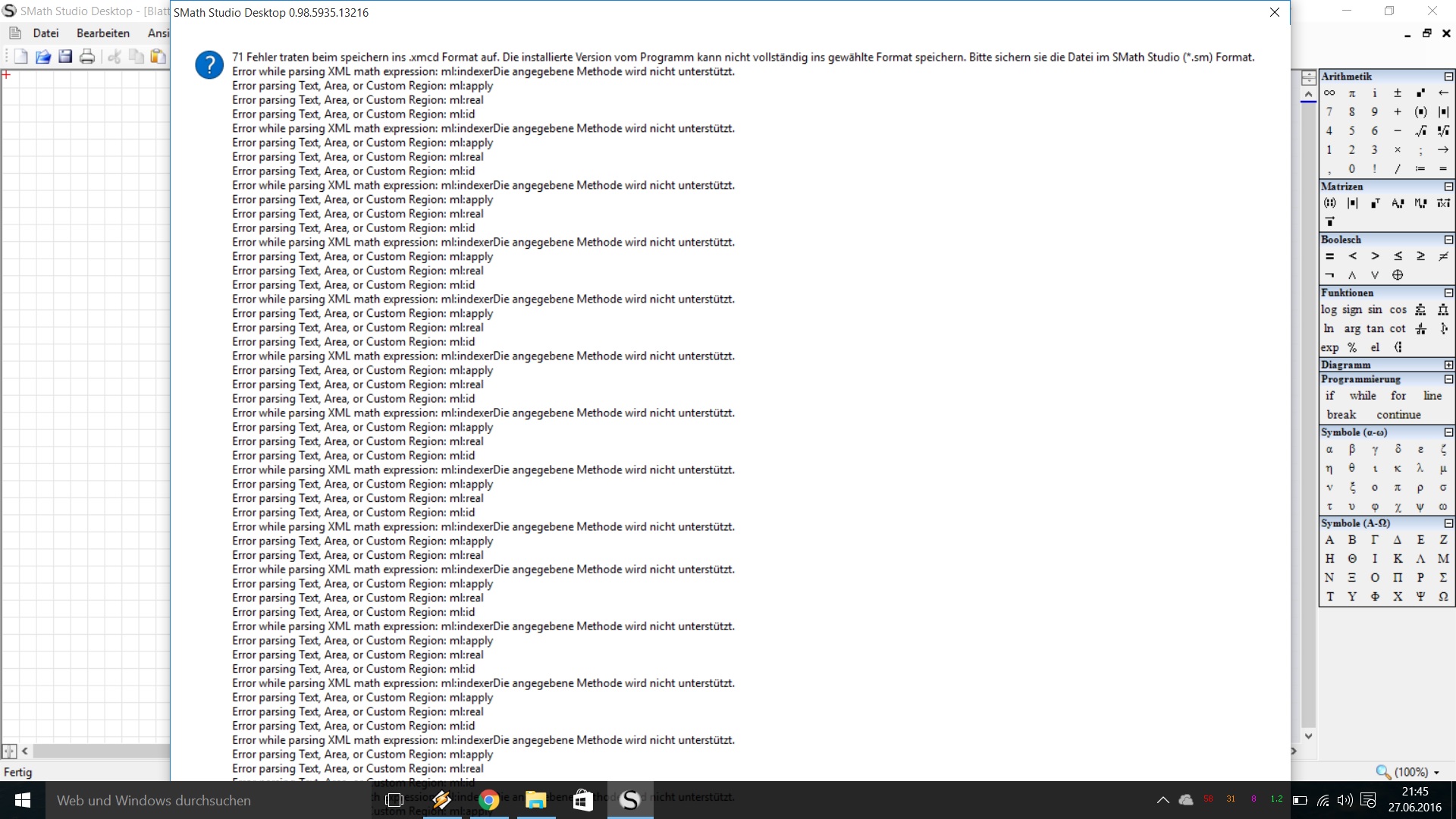

Stefan Müller
Stefan Müller
0 likes in 45 posts.
Anyone has an answer?
Thx
edit: Screenshot of the error message
Show Spoiler
please don't delete any post if it contains bug infos
