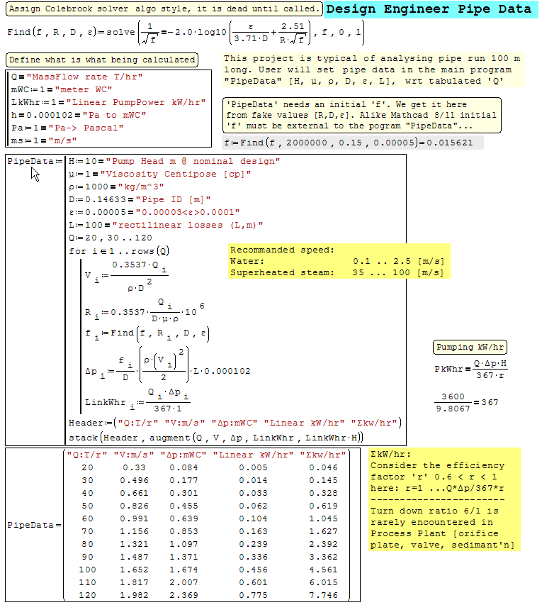

By same token of "Pipe Data", Colebrook Moody has been refactored.
Observe carefully the code to make the 'solve block' survive by
introducing it within a program structure. In this implicit solve,
the block needs an [one] initial value. Same code structure as
it was discovered in Mathcad 8/11 [undocumented].
A splendid piece of Engineering work for publishing and documenting
the project, tracable for the client's archive.
Inst_Colebrook MOODY.sm (16.74 KiB) downloaded 1439 time(s).
Inst_Colebrook Pipe Data.sm (24.35 KiB) downloaded 1386 time(s).

JeanInst_Colebrook Pipe Data.sm (60.85 KiB) downloaded 1376 time(s).
